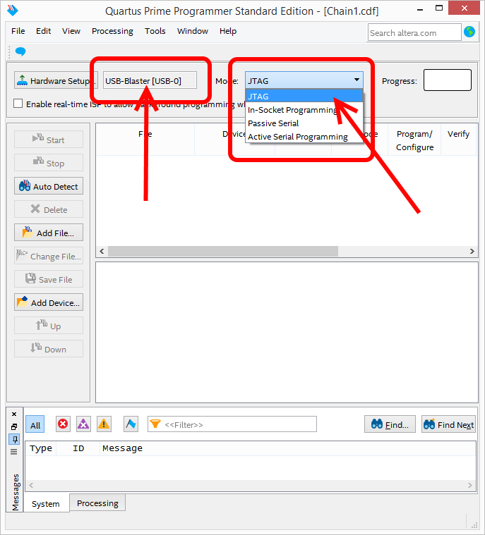

- the USB blaster is then recognized/listed in Quartus Prime Programmer

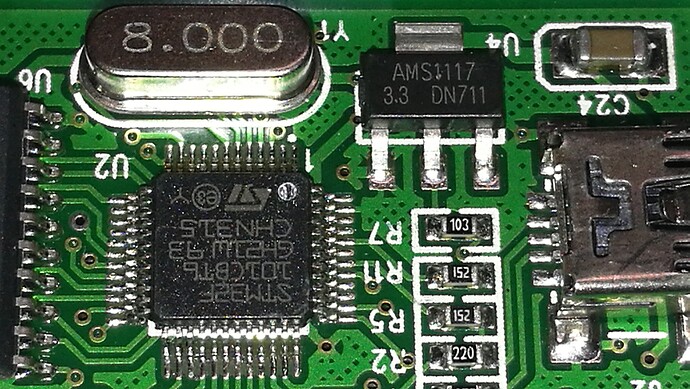

Some pictures below about the chips inside the USB Blaster and the Quartus Programming sw.
