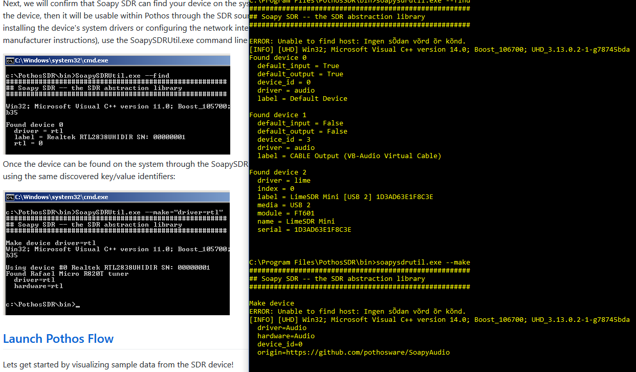

I have now managed to install the driver from FTDI. I’m following the tutorial on Tutorial · pothosware/PothosSDR Wiki · GitHub and bumping into problems when I’m trying to verify that the device can be found. The error message is “Unable to find host” That message comes up in Pothos Flow too.I can’t get it working in Pothos Flow. Not sure if I missed something somewhere…
