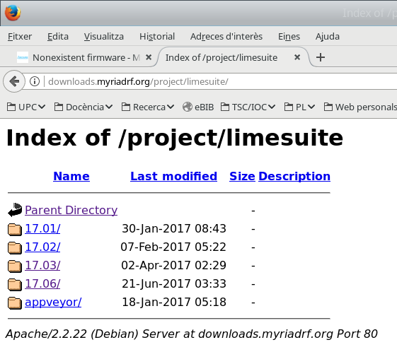

So, I go to a terminal to run «LimeUtil --update», but apparently it searches for a file that does not exist on the web:
Oh, sorry, I put the space by accident when cut&pasted the code here. The original line doesn’t have the space, obviously.
Seriously, I think the problem is that the git version of LimeUtil (I just compiled it) tries to look for an image from the 17.07 folder and this folder isn’t on the web yet:
The images don’t change with every Lime Suite release, but something obviously isn’t right, whether it’s the process of copying files on the downloads server or — as I’d have thought — the logic used when a non-tagged build checks to see if the board as the appropriate images loaded.
I have looked at the code and found out that the version number is taken from the latest entry in the changelog.txt. Which currently on master branch is “Release 17.07.0 (pending)”. So that is the problem.
Actually I am not sure why we need to include version number in file path as image names already contain their version (e.g. ‘LimeSDR-USB_HW_1.4_r2.8.rbf’ is exactly the same in 17.06 and 17.03 folders).
The fpga/fw images are versioned with the release major/minor. The tools look here for images: http://downloads.myriadrf.org/project/limesuite/ So, I made a copy of the last release to 16.07, but be careful to do that when making a new major.minor version. Should be ok now
