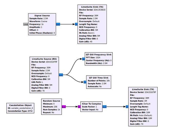

I am using two different LimeSDR Mini v2.4 for a very simple sine wave transmission using gnuradio:
The LimeSDR Mini v2.4 Tx and Rx both come up when you are using same LimeSDR for transmitting and receiving. However, whenever I use two different LimeSDRs for transmission and reception, the Rx of the receiving LimeSDR doesn’t come up.
A quick fix is to send a single random source sample out of the Tx of the receiving LimeSDR which then turns on its Rx, but this is not a permanent solution.
Is there something else that can be done to turn on the Rx of the LimeSDR when it is not transmitting at all?
