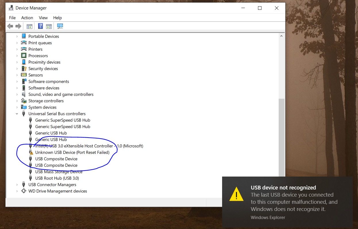

I am getting the “USB device not recognized” error and in Device Manager appears as “Unknown USB device (port reset failed)”, screenshot attached.

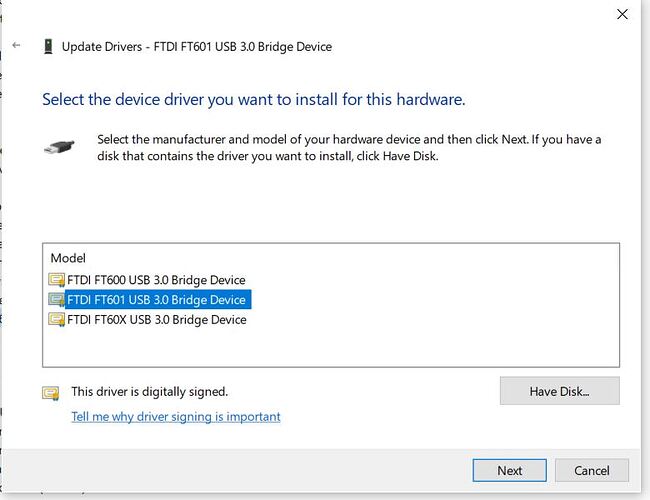

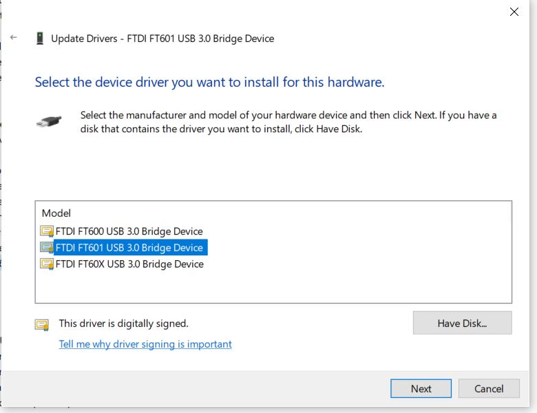

I have followed exactly the steps from the provided link. On USB 3.0 works perfect, but on USB 2.0, Windows says that the best driver is already installed. Then I uninstalled and erased the driver and tried to install it from scratch, but again I am getting the same message “the best driver software for your device is already installed”.

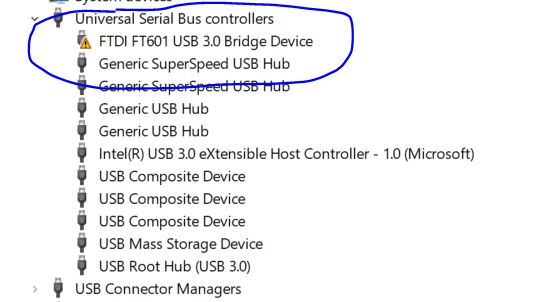

I even disabled driver signature enforcement and started Windows in safe mode, then manually installed the driver. The USB device still appears with an exclamation mark on device manager.
