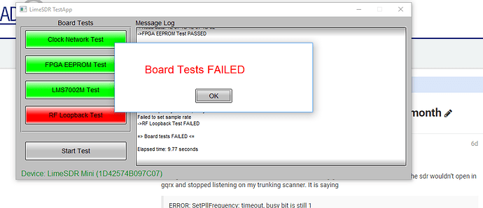

I bought a Lime SDR Mini mid november and it was working great. then out of nowhere the sdr wouldn’t open in gqrx and stopped listening on my trunking scanner. It is saying
ERROR: SetPllFrequency: timeout, busy bit is still 1
it will not open, I have tried on windows and linux(ubuntu) usb 3 and 2.
I have tried updating the firmware it is currently on 1.27.
[ TESTING STARTED ]
->Start time: Sat Dec 22 14:43:13 2018
->Device: LimeSDR Mini, media=USB 2, module=FT601, serial=1D42574B097C07, index=0
Warning: USB3 not available
Serial Number: 1D42574B097C07
[ Clock Network Test ]
->REF clock test
Test results: 26698; 39895; 53091 - PASSED
->VCTCXO test
Results : 6711064 (min); 6711219 (max) - PASSED
->Clock Network Test PASSED
[ FPGA EEPROM Test ]
->Read EEPROM
->Read data: 12 07 1B 12 07 1B 02
->FPGA EEPROM Test PASSED
[ LMS7002M Test ]
->Perform Registers Test
->External Reset line test
->LMS7002M Test PASSED
[ RF Loopback Test ]
->Configure LMS
Failed to set sample rate
->RF Loopback Test FAILED
=> Board tests FAILED <=
Elapsed time: 9.77 seconds
