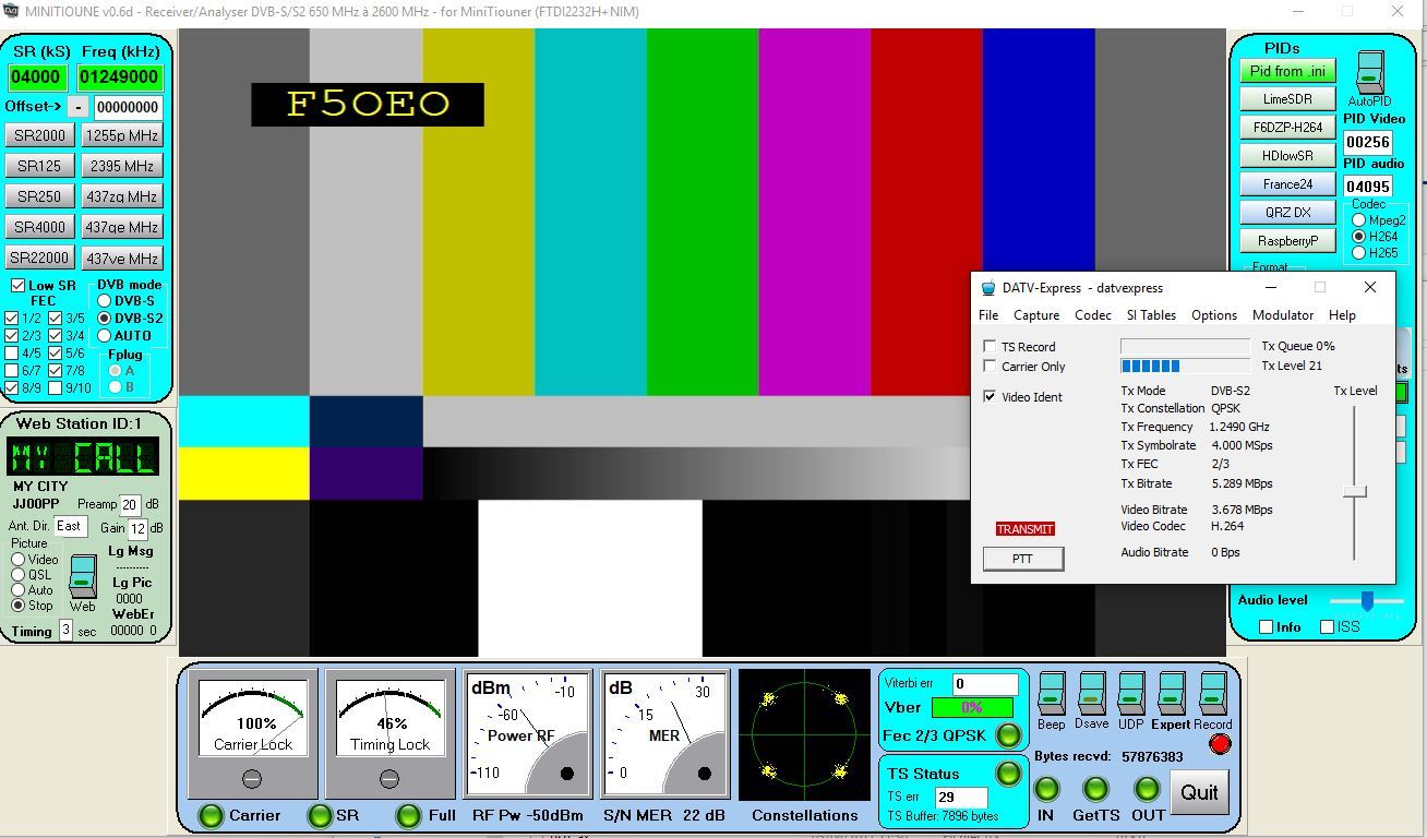

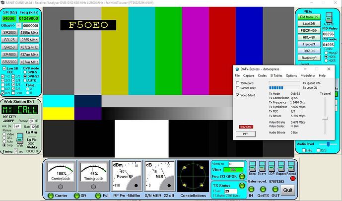

Well done : DVB-S2 tx through LimeSDR and received with minitioune .
