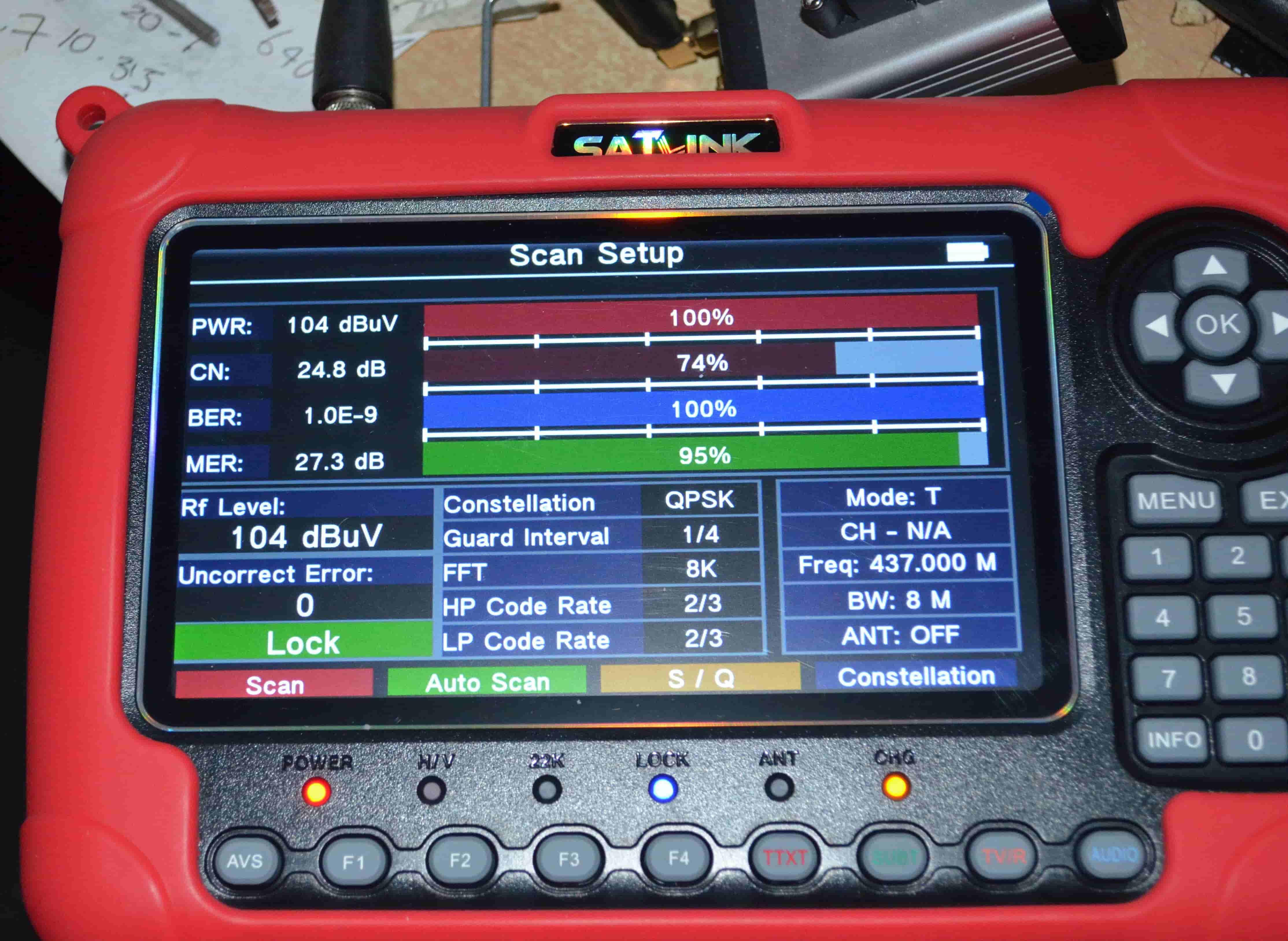

This is similar to a thread on the BATC forum about Lime Mini and high symbol rates. It works on some P.Cs but not on others probably down to the PCs USB3 performance. Here is proof that it does work (at least on my PC).
  • Charles

Indeed, some PC USB 3.0 chipsets seems to perform better than others. The cable used can also have an effect if it causes too much of a voltage drop.
