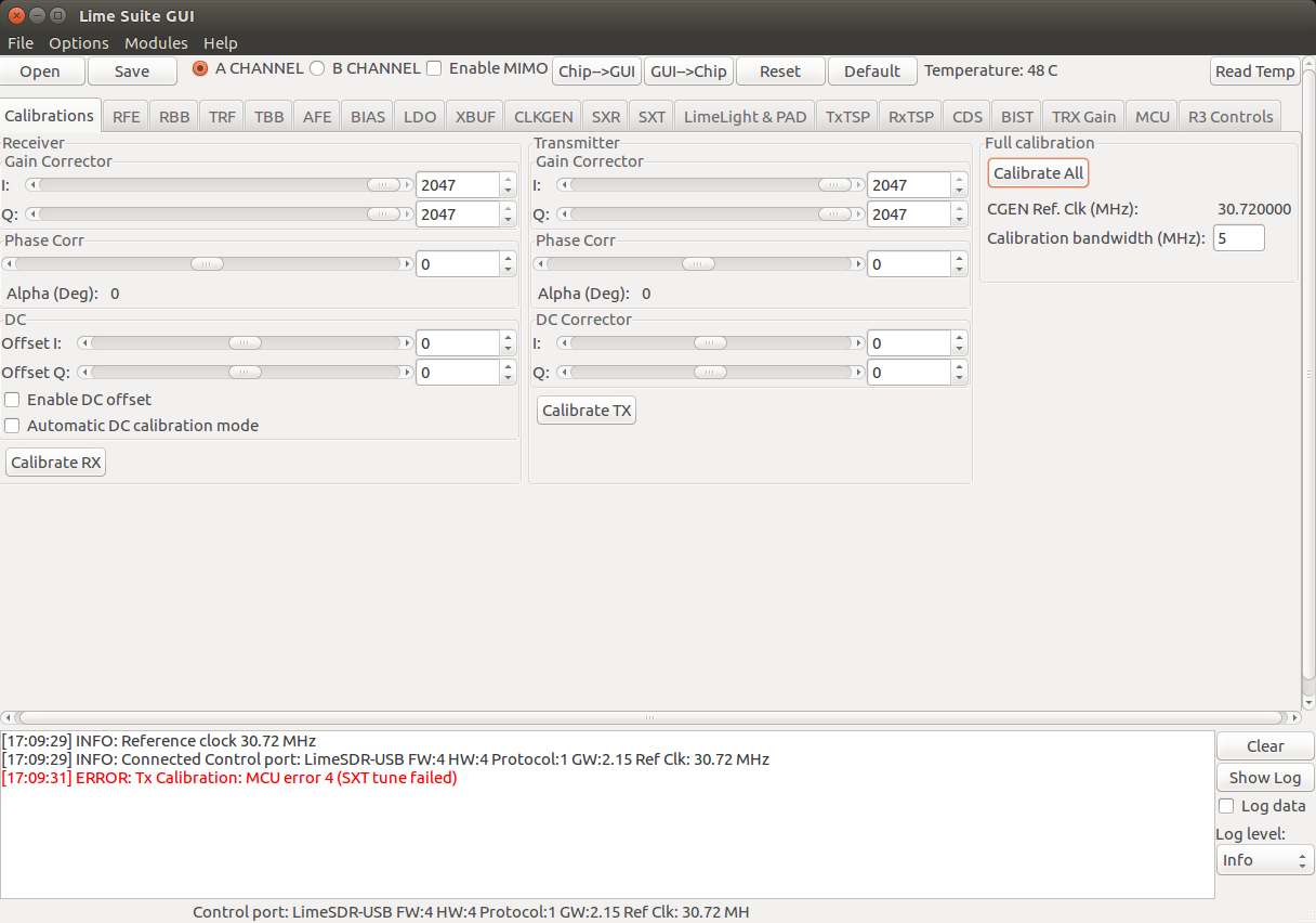

Hello, I’m trying to calibrate my SDR, but I got this error:
![Снимок экрана от 2018-04-06 17-09-38](https://discourse.myriadrf.org/uploads/default/original/2X/2/2530560026fcf372cc02d6395f7becdbe783b7a9.png)
how can I fix this?
Have you configured transmitter to desired working conditions before attempting calibration?
Seems no. How can I do this? I’m going to use my limesdr with osmo trx
for calibration to work you need to configure at least the transmitter center frequency and sampling rate. Osmo trx will do that and will run calibration.

After last update I got this:
[04:08:31] ERROR: Tx Calibration: MCU error 4 (SXT tune failed)
[04:08:46] ERROR: Tx Calibration: MCU error 4 (SXT tune failed)
[04:11:17] ERROR: Rx calibration: MCU error 3 (SXR tune failed)
[04:11:24] ERROR: Rx calibration: MCU error 3 (SXR tune failed)
[04:11:30] ERROR: Tx Calibration: MCU error 4 (SXT tune failed)
