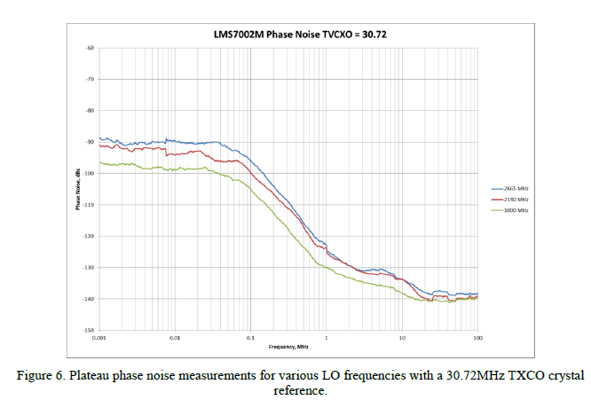

I have been testing my LimeSDR with MXA N9020 signal analyzer these days. I found that the phase noise of the Limesdr is pretty bad and didn’t meet the spec in the datasheet of LMS7002M chip.
I use the LimeSuite GUI for testing and generate several carriers. I think is an issue about my settings. Someone can provide me a suitable .ini file?
Here post my test plot.
Meanwhile, I test a LTE TM3 QAM64 20MHz signal with the .wfm file you provide. Why the EVM is such terrible?
Hi @Dynamix_yang,
Could you describe please how do you configure (assuming) LimeSDR-USB board. What RF output do you use?
Hi Zack,
I tried both TX1&2 High&low. The phase noise seems to be the same and is only related to the frequency.
I use “TX_power_measurement.ini” download from the other topic to do the test. I also use “self_test.ini” and “example.ini”, but things haven’t changed.
Here posted the “TX_power_measurement.ini”.

Hi Zack,
I have noticed that the test data in RF and Analog Measurement Results document is better than my test data post above. Since the LMS7002EVB may have a more serious design for evaluation and the reference frequencies are different, can you guys provide us an official LimeSDR USB/mini tx phase noise measurement and a test configuration like your did for Tx output power measurement?
Hi @Dynamix_yang,
Our phase noise measurements can be found here:
https://wiki.myriadrf.org/LimeSDR-Mini-Phase-Noise

For reference, following is my phase noise measurement at 2665 MHz using attached LimeSDR mini phase noise 2665MHz.ini file with ref. clock changed to 30.72 MHz.
Thank you very much for the continuous support. You and your team are so responsible and professional.
BTW, glad to tell you that there are many learners in China like LimeSDR and backed this project in Crowded Supply despite the high tariff. The LimeSDR is an excellent tool for me and my friends to learn signal processing and communication theory, and thank you and your team bring such a great thing to us.
Wish Lime have a bigger achievement!
Have you tried to connect an External Reference like 10 MHz OCXO?
Hi @Dynamix_yang,
You use LimeSDR-Mini register settings file on a LimeSDR-USB board for your PN measurements. You should measure LimeSDR-Mini board ONLY with these.
We will provide same measurements and register settings for LimeSDR-USB in a while.
Hi Zack,
Thanks for reminding. I’m looking forward to your measurements and register settings.
Could you give us some advice about how to improve the PN performance by setting some key registers?
Like which combination of Rzero, Cp, Cz, should we use in PLL loop filter? The higher CLK_H or lower CLK_H is better?
Hi Booth,
I have tried the 10MHz out from a MXA N9020 Signal analyzer and the PN seems not to improve much.
I’ve bought a used ISOTEMP OCXO82-108 from AliExpress and I will test it after arriving.
Since the internal VCTCXO RPT7050A has very good PN performance (-130dBc/Hz@100Hz), I don’t think an ext. OCXO will improve much.
Thanks for helping:)
Are the phase noise performance data and test settings of the LimeSDR USB board going to be released?
