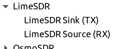

I am very new to SDR, everything works fine until I try to connect it to GNUradio. I’m not familiar to it so my question cna be very trivial, however I have followed the GR-LimeSDR installation but when I open it in GNUradio there is no front end module (LimeRFE) as in the tutorial.
What can I do to have this module?

I’ve already installed the gr-limesdr and like I’ve said, LimeSDR Sink (TX) and LimeSDR Source (RX) shown up but there is nothing to configure the frond end (Lime RFE Control) like in the tutorial shown here https://wiki.myriadrf.org/Gr-limesdr_Plugin_for_GNURadio
Just to be sure I do it again but it says “gr-limesdr is already the newest version (3.0.1-2build1).
0 upgraded, 0 newly installed, 0 to remove and 12 not upgraded.”
