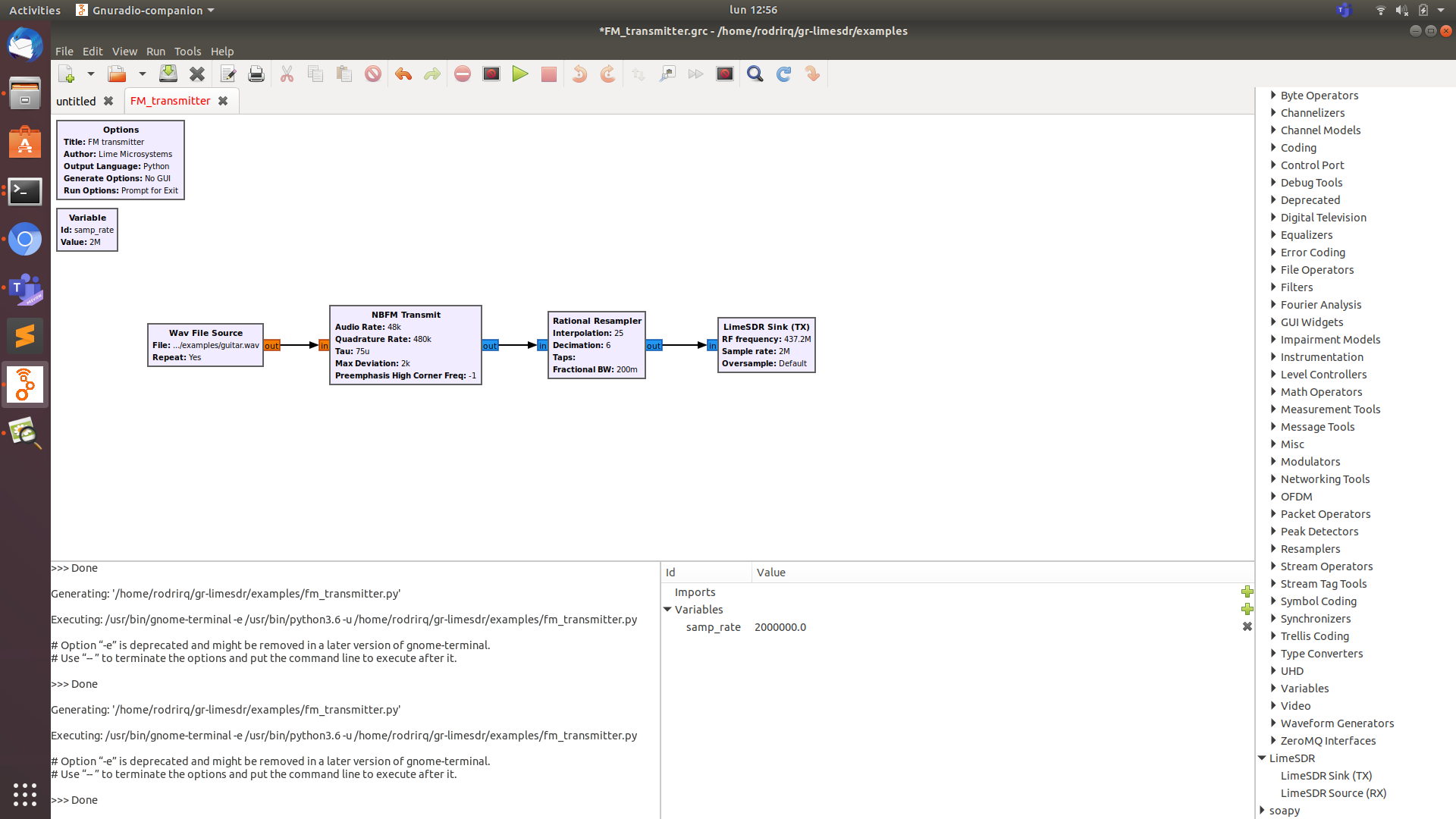

Hello, I have gnuradio 3.8, LimeSuite and gr-limesdr cross-compiled on the Zybo Z7-10.
I tried to modify the FM_TRANSMITTER to check if the setup works.
This is the output after the python3 command:
Any ideas?
