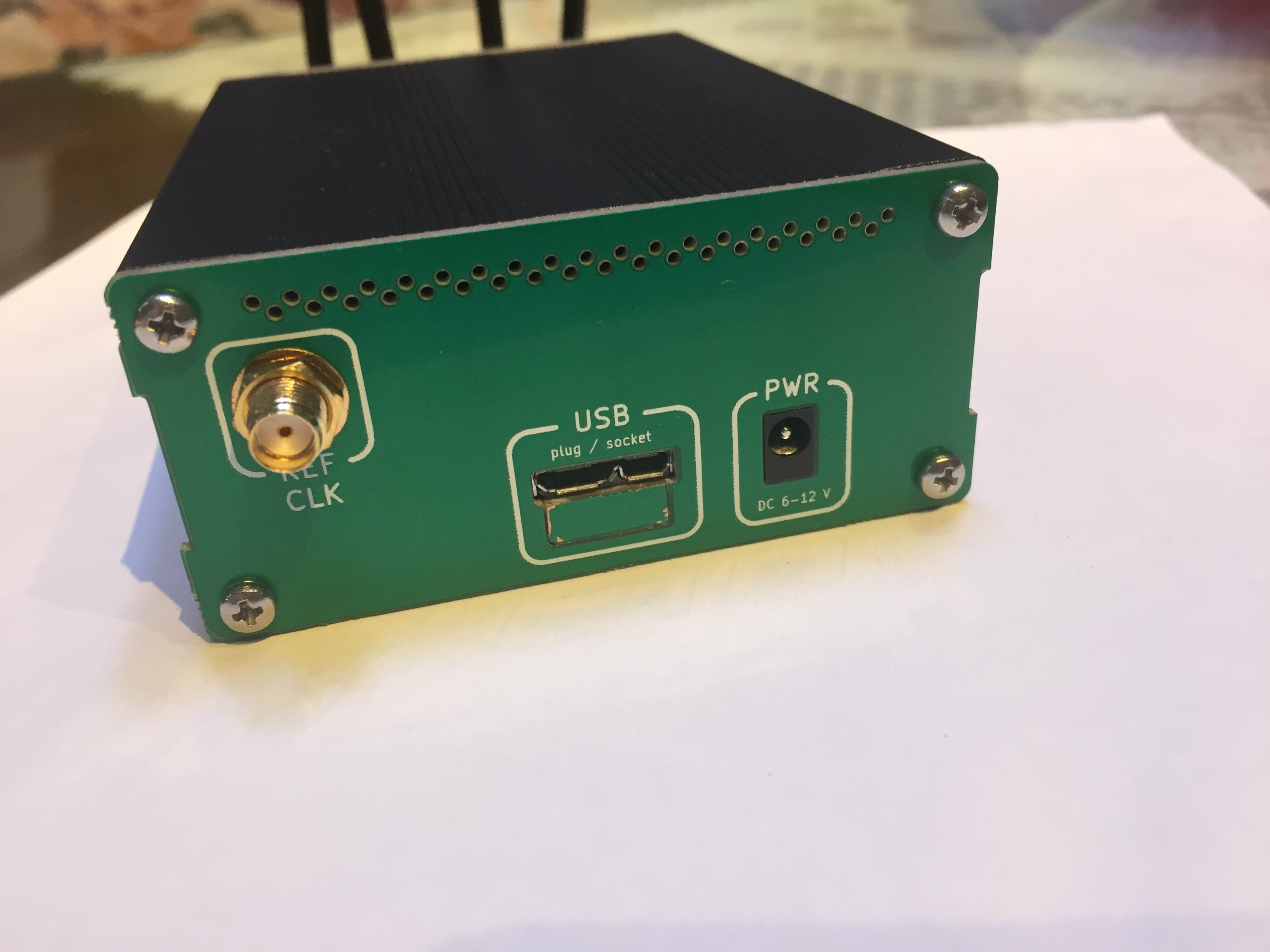

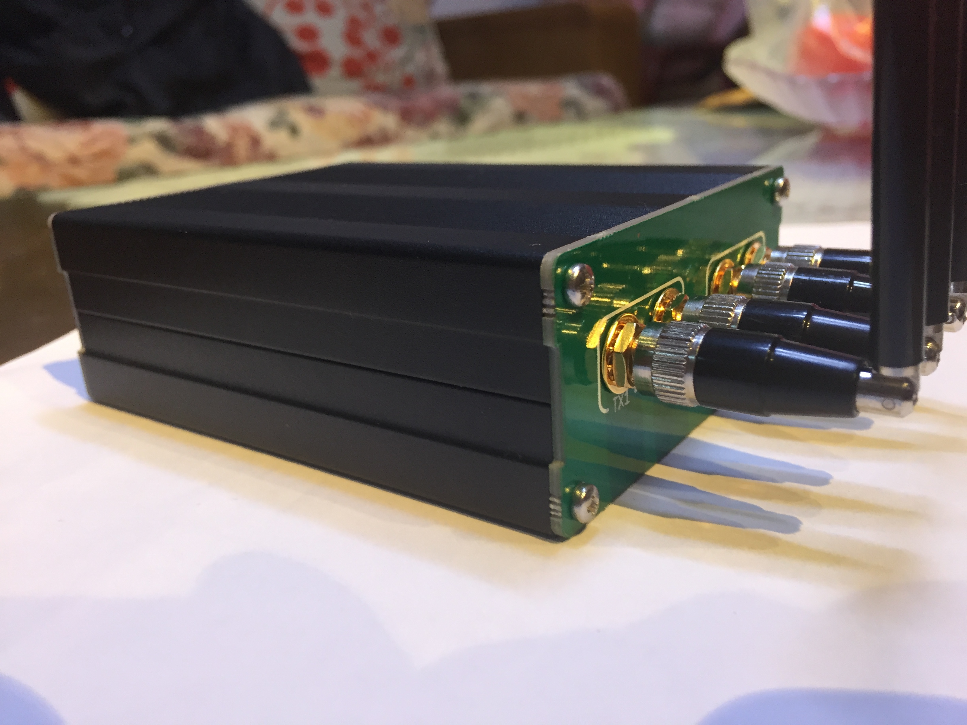

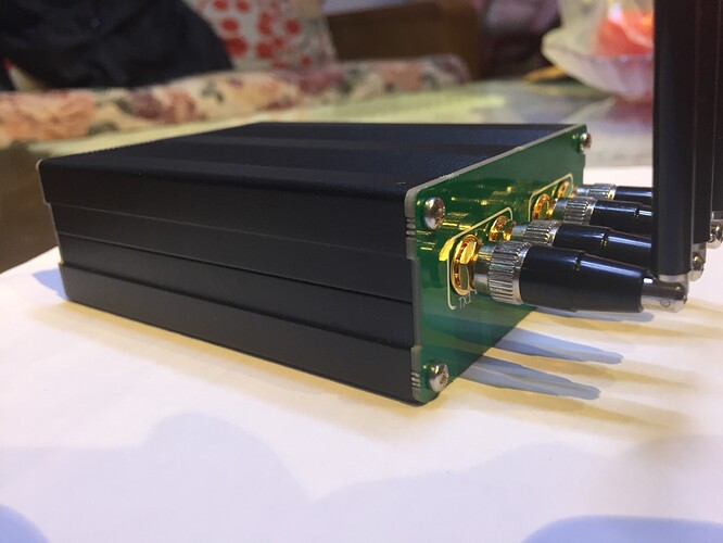

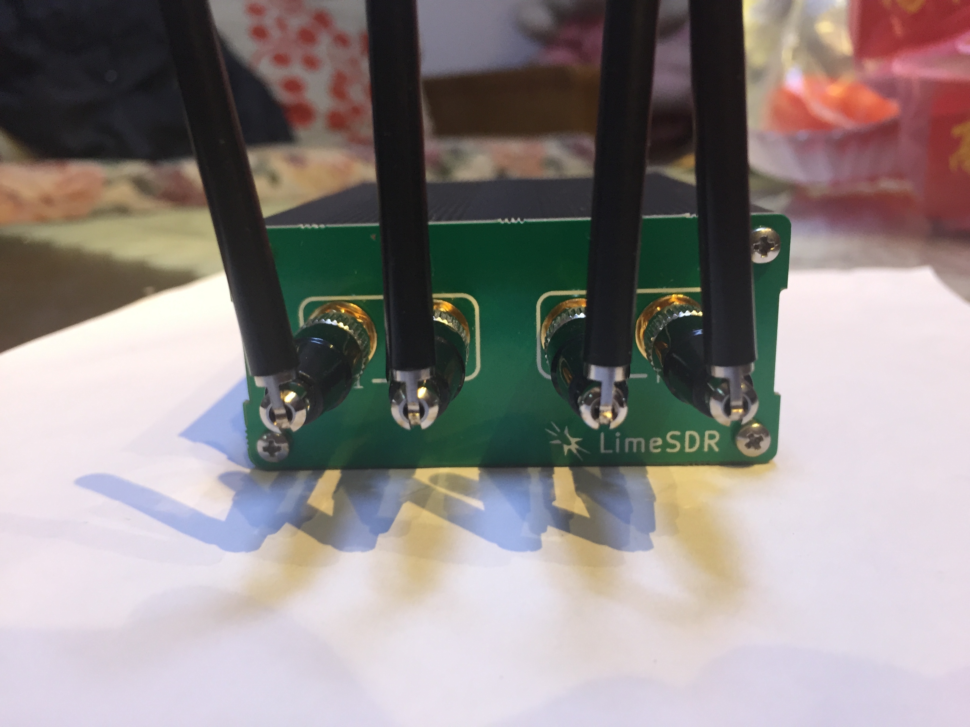

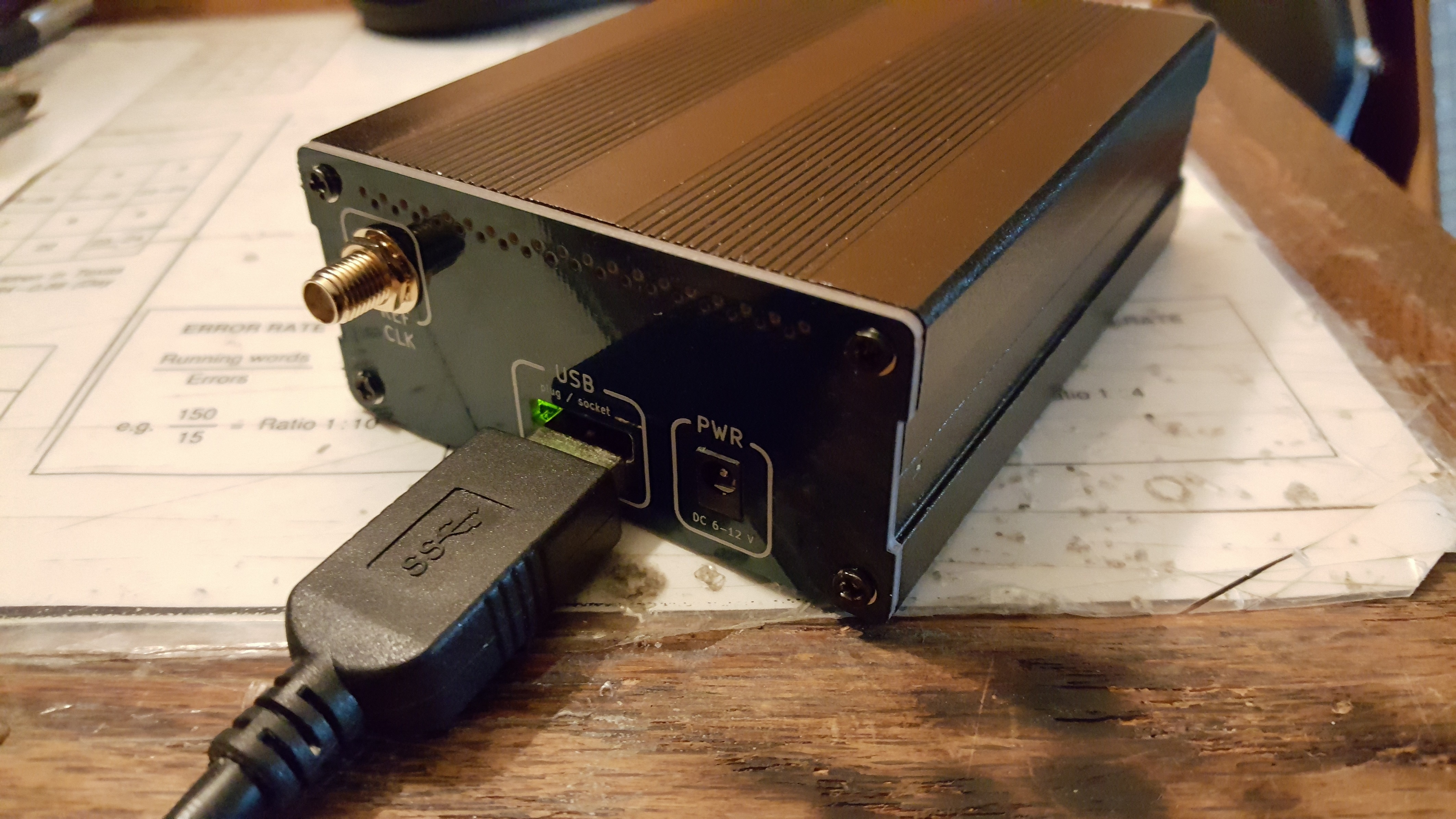

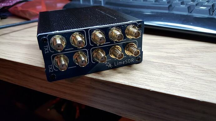

I’m attaching pictures of the Luftek case for the LimeSDR as I assembled it last night. I think the quality, detail, construction and overall appearance of this case is WONDERFUL..!! Love how it looks and has ALL the functionality of the LimeSDR on the back panel. Here are the pictures I took as it was assembled and in final form:
I would HIGHLY recommend this case to anyone that wants the full functionality of the LimeSDR right at their fingertips and cased up in a high class package. Ziga has done a GREAT job with this and when my other LimeSDR arrives in the mail I will be casing it up with another case from Luftek..!
Looks Great!
Thank for luftek
Very impressive
