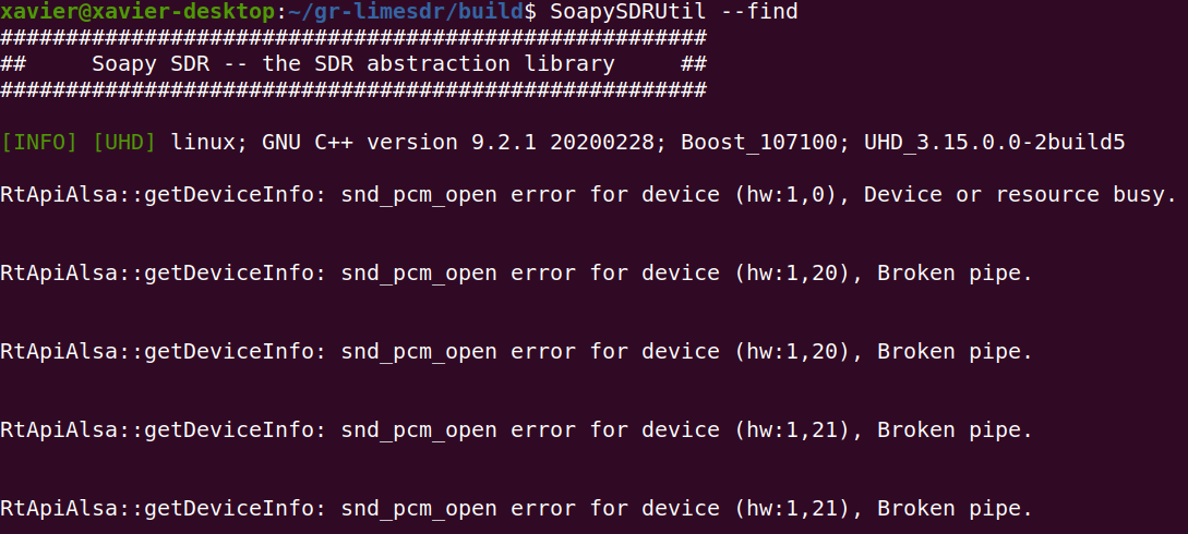

Then I SoapySDRUtil --find and here is result:
I tried many ways could you please help me. I using [

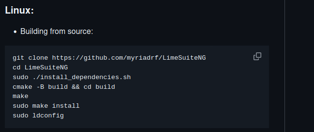

here is result that I got when I install " Lime Suite NG" :GitHub - myriadrf/LimeSuiteNG
I follow the step here is the first
and this is a second

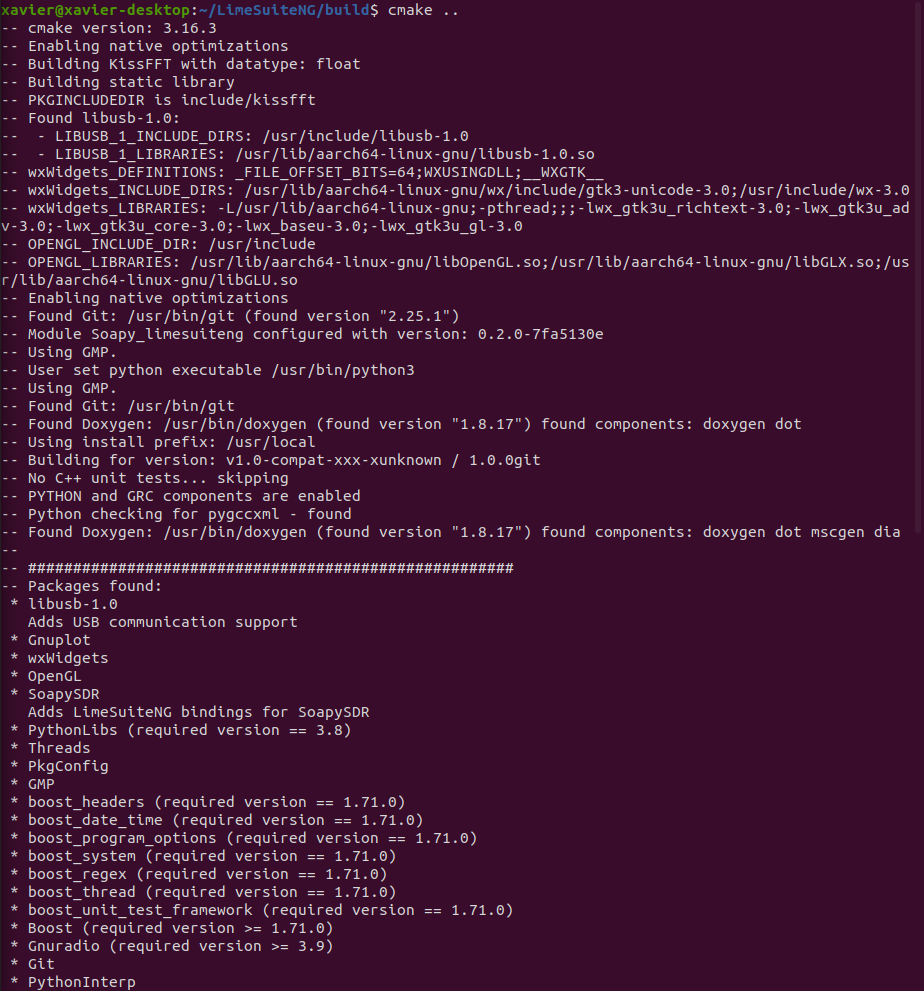

When I do a cmake i got this
Screenshot from 2024-10-15 17-53-23
how to solve it?

If you did sudo apt install linux-headers-$(uname -r)
and with cmake you see:
-- ## LimeSuiteNG enabled features
 * LIMEPCIE, PCIe support
 * LIMEPCIE_KERNEL_MODULE, Build Linux LimePCIe kernel module
Then you can ignore the missing LinuxKernelHeaders note, the script that detects if headers are installed was made for x86 system, so it currently doesn’t handle Arm architecture naming scheme like that linux-headers-5.10.216-tegra-ubuntu20.04_aarch64

Here is my result of ''cmake .." I’m not sure this is working and I can do “make” or something missing?

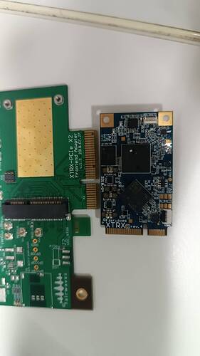

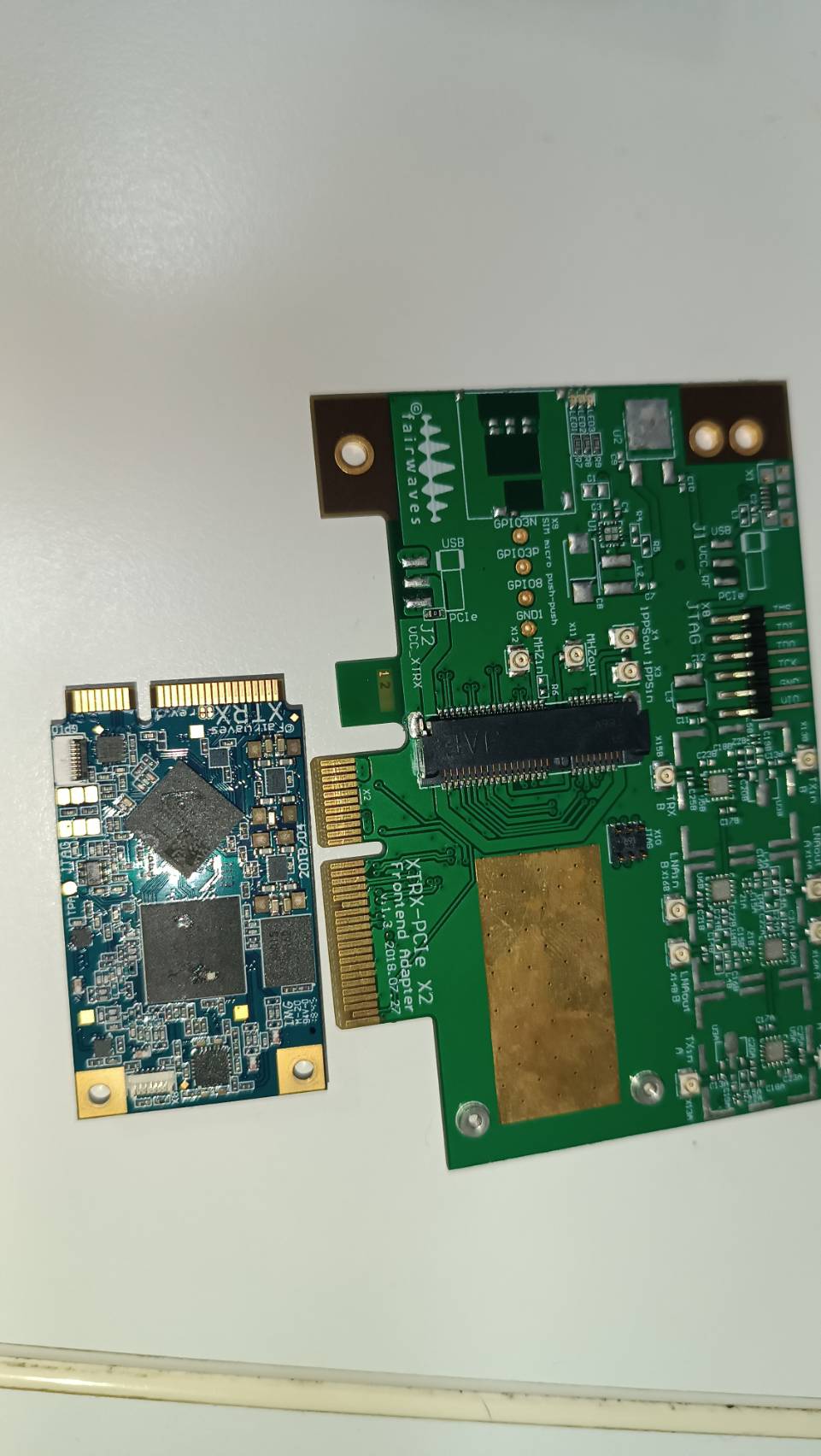

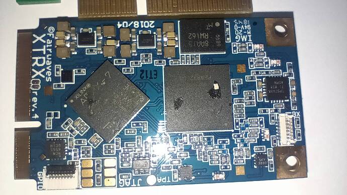

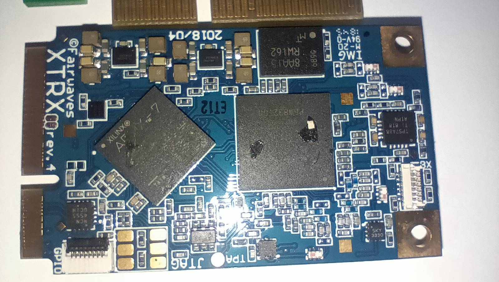

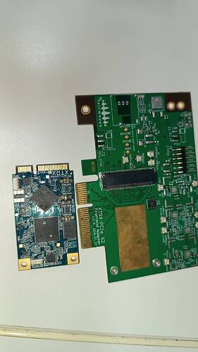

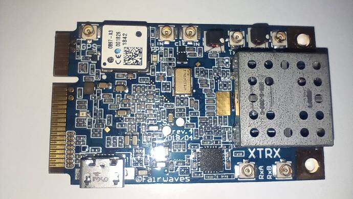

Here is my board
You have Fairwaves XTRX rev. 4 board. It’s not supported in LimeSuiteNG.

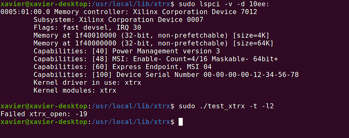

I found device on lspci but when using test_xtrx I got failed xtrx_open
I’m not familiar with the original Fairwaves xtrx software stack.
You can see the device using “lspci” that means your system can see it and basic PCIe communications are functioning.
But the the -19 (ENODEV) code comming from xtrx driver suggests, that the xtrx driver encounters some kind of problem while initializing the device.
You should check "sudo dmesg | grep xtrx" for any kind of error messages.
here is message
Hmm, can you send the whole “dmesg” log without grep? I suspect there could be DMA addressing problems, you’re using 64bit operating system, but the xtrx driver supports only 32bit addressing. Some Arm based systems are not happy about that.
