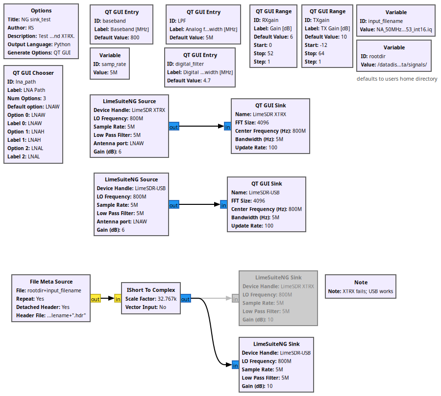

My XTRX accepts a stream from a file with limeTRX without an error and LimeSuiteNG sink will transmit data from the same file with radio limeSDR-USB. However, LimeSuiteNG sink does not work (same file again) using radio limeSDR XTRX and produces the following error:
“LimeSuiteNG :info: Sampling rate set(50.000 MHz): CGEN:400.000 MHz, Decim: 2^1, Interp: 2^1
thread_body_wrapper :error: ERROR thread[thread-per-block[2]: <block sdrdevice_sinkLimeSDR XTRX>]: argument not found”
limeSuiteNG (commit cc7bc6fed420361fe7307b9e1299c4f2df398ce2), gnuradio gnuradio v3.10.12.0-rc1 (35b0664) .

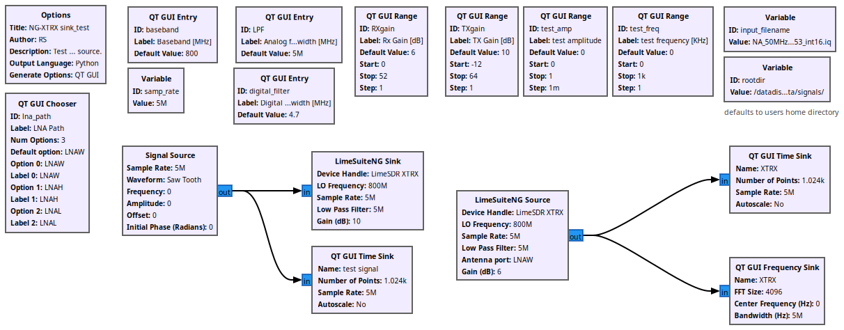

The flow graph below tested combinations of LimeSDR-USB and LimeSDR XTRX as sink or source. The results are:
(1) USB source and sink works as expect.
(2) XTRX source with USB sink produces a highly distorted spectrum and logs repeated warnings that I don’t understand at this time:
swFIFO:512
LimeSuiteNG :warning: USB ep:81 Rx0: 20.079 MB/s | TS:9999060 pkt:9803 o:9291(+4902) l:0(+0) dma:9803/9804(+1) swFIFO:512
LimeSuiteNG :warning: USB ep:81 Rx0: 20.079 MB/s | TS:15000120 pkt:14706 o:14194(+4903) l:0(+0) dma:14706/14706(+0) swFIFO:512
(3) Both XTRX and USB sources with USB sink works as expected with the warning only sent once:
LimeSuiteNG :warning: USB ep:81 Rx0: 20.079 MB/s | TS:5000040 pkt:4902 o:2091(+2091) l:0(+0) dma:4902/4902(+0) swFIFO:0

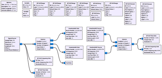

The two flow graph images attached are essentially identical except for the device handle in the sink; one is the USB device, the other is XTRX. I require another communication channel (like email) to send you the *.grc files.

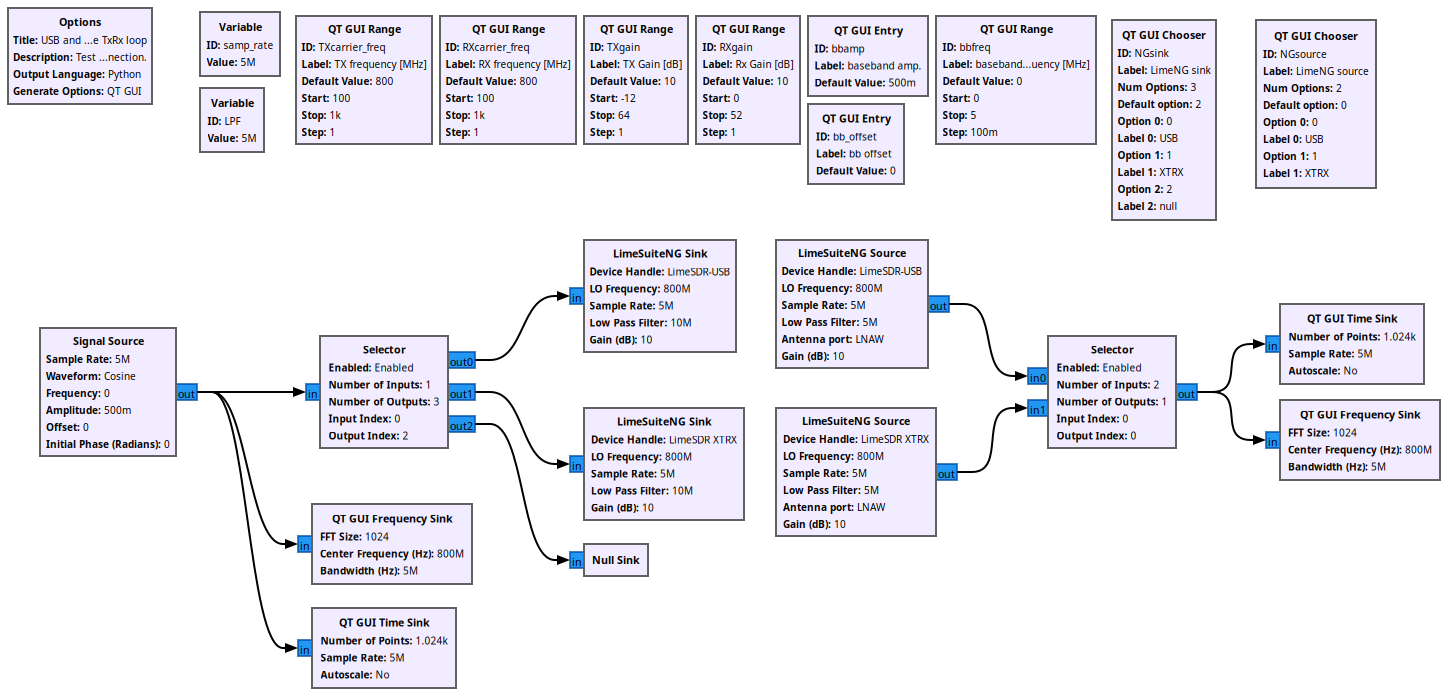

Thank you for this information. I still receive this error but I can’t say whether it’s consistent. I have assembled a very simple flow graph to investigate this particular issue further by identifying conditions and sink block settings under which the error in question consistently occurs. I am using an older build (6f4c28d3) of LimeSuiteNG but will now rebuild before continuing. I’ll provide more detail and progress update later today or tomorrow. Please keep me posted with whatever you discover about the XTRX operation with gr-limesdrng. I am very interested in having this device working properly within gnuradio.
Rick
Timothee
Thank you for this information. The only flow graph (of many attempts) for which I have had success with the sink block using the XTRX is a very simple flow graph created specifically to investigate this particular issue by identifying conditions and sink block settings under which the error in question consistently occurs. I don’t understand why this works but the input selector block is necessary; feeding the signal source directly into the XTRX only or both the USB device and XTRX in parallel consistently results in the XTRX thread_body_wrapper error. I have just started experimenting but switching between the null sink and XTRX repeatedly will work anywhere from 1 to a half dozen times before the error occurs. Switching from the XTRX to the USB device will work only once; switching back from USB to XTRX fails. The latest build of LimeSuiteNG was used and the XTRX TX is connected to the USB RX. Perhaps I have created an invalid flow graph so please inspect and comment while I continue exploring this. I have place a copy of TxRx_loop.grc on github link sent on the April 16 post.
