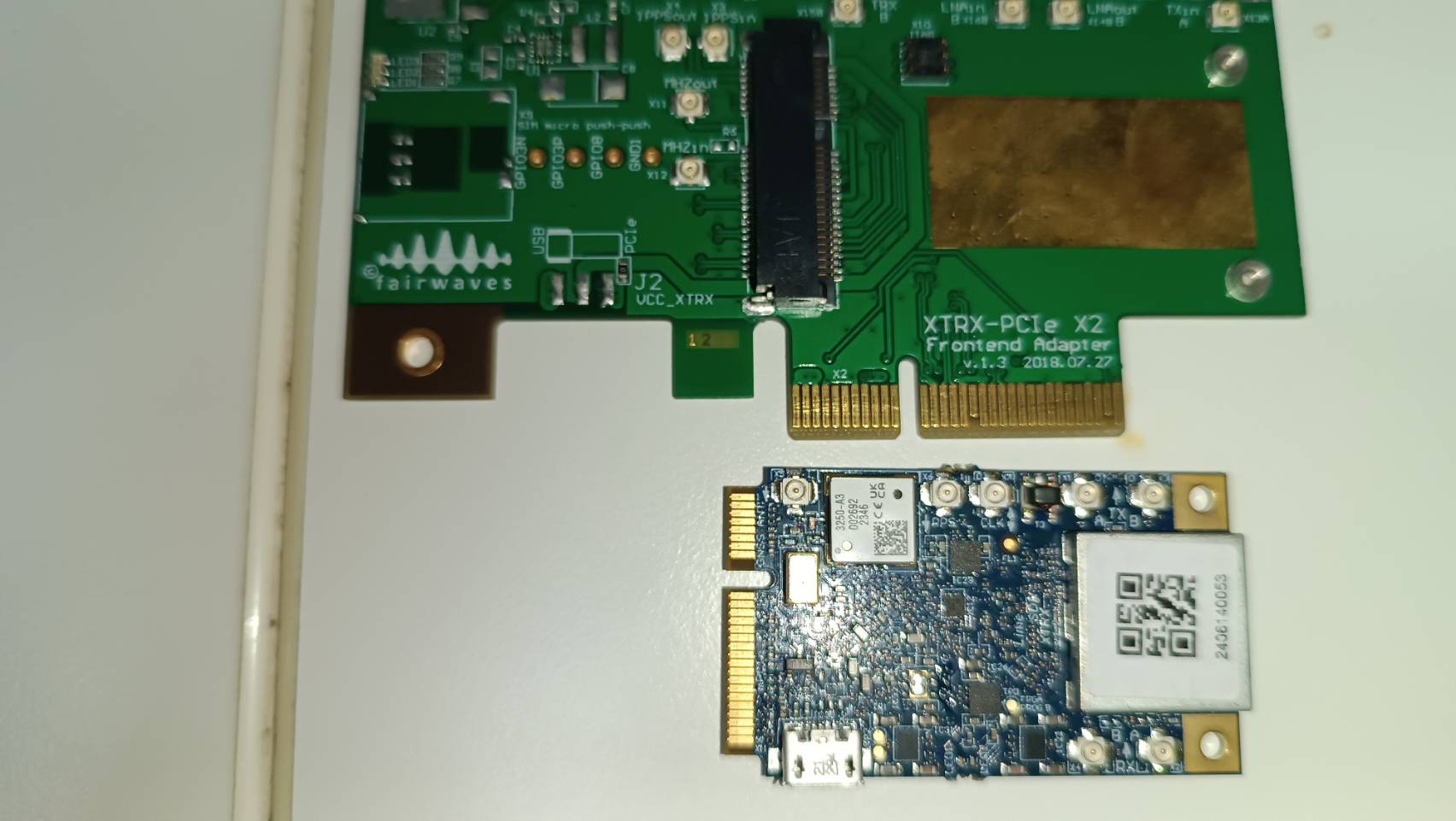

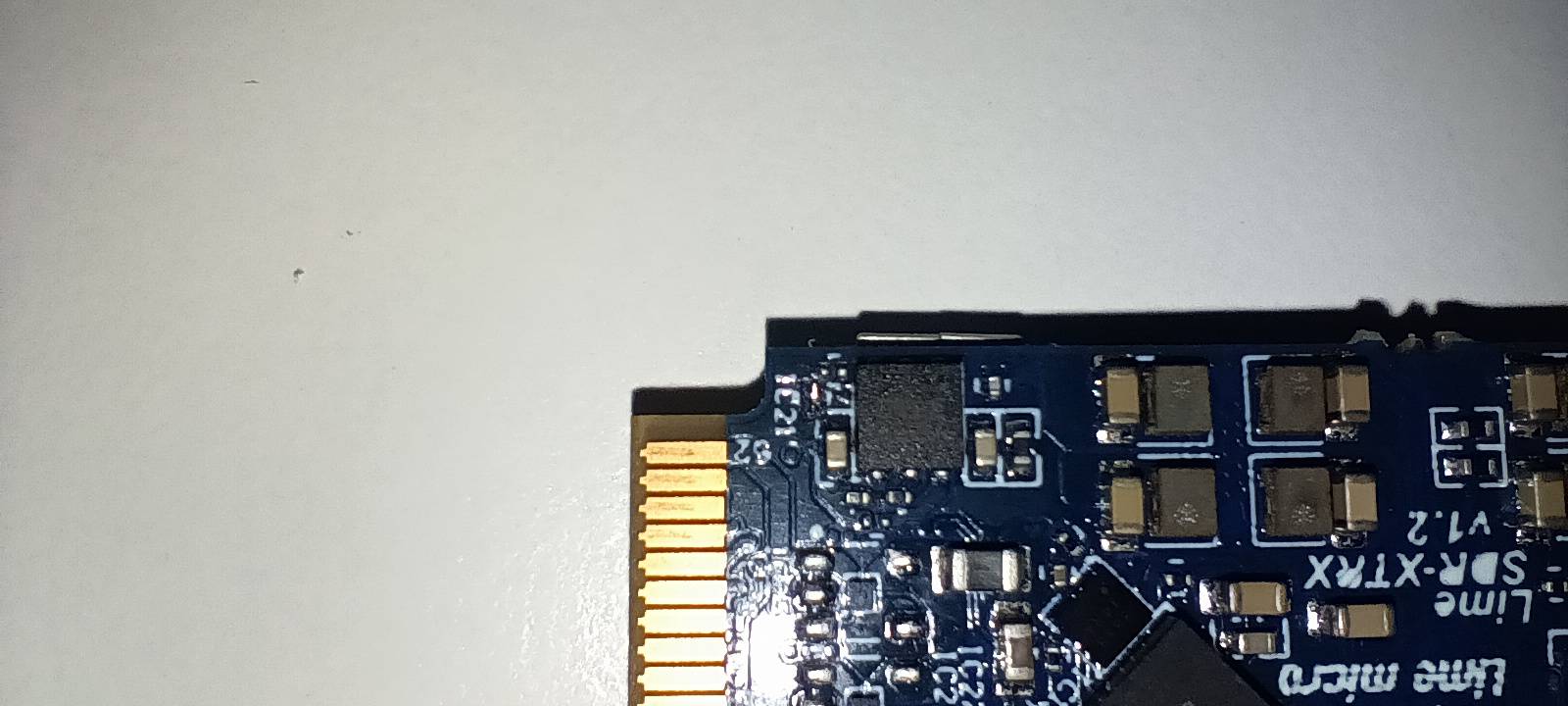

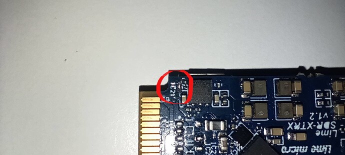

Sorry for my bad sir, now I found limeSDR XTRX board. I started follow the step by soldering a 0 Ohm resistor then install LimeSuiteNG from this link :GitHub - myriadrf/LimeSuiteNG

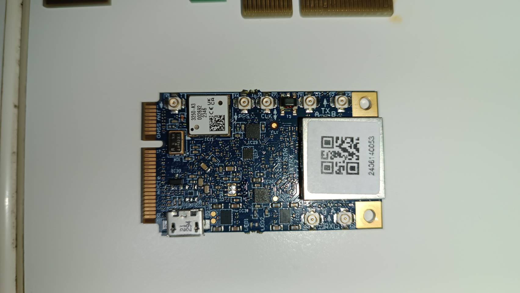

I have question how do I test receiver for 2 ports?
There is 2 ports of receivers RxA and RxB , I would like to test it, to check that working, do you have any an idea?
