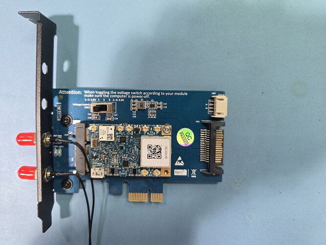

I am reaching out to report a critical issue I am experiencing with my recently purchased LimeSDR XTRX. Despite multiple attempts on various systems and interfaces, the device is not being recognized or communicating in any way.
Issue Summary:
  • Device: LimeSDR XTRX
  • LED Status: Both LEDs light up upon power, indicating some basic operation. just keep blinking
  • System Connection Attempts:
    • PCIe Interface: Tried connecting directly to the motherboard via a compatible PCIe slot — no recognition, no dmesg output on Linux, and no detection on Windows Device Manager.
    • USB Interface: Attempted connection using a known-good micro USB cable on both Windows 10 and Ubuntu 22.04 — again, no logs, no recognition.
    • Alternative Systems: Tested on multiple computers with various chipsets and OS versions, but results remain the same.
  • Software Tools: Attempted to use LimeUtil, dmesg, and other diagnostic tools under Ubuntu — all show no sign of hardware presence.
  • Power Supply: Device appears to receive power (LEDs are ON), but no enumeration or communication occurs.
Actions Taken:
  • Use it and tested PCIe adapter.
  • Verified all cables and slots with other hardware.
  • connect also side micro USB but without any communication , but LED keep blinking

I am attaching photos of the current hardware setup and can provide any additional logs, serial numbers, or video evidence upon request.

Hi, check if your board has this component: XTRX not found - #12 by ricardas
USB interface is not used on the LimeSDR XTRX
Also XTRX is to be used with GitHub - myriadrf/LimeSuiteNG software.
