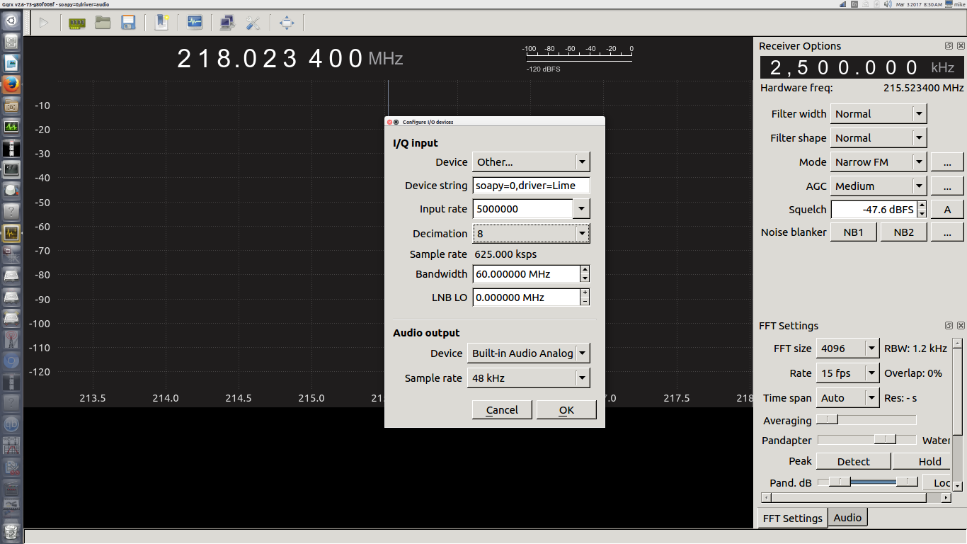

This was a screen capture from my Ubuntu Laptop … no LimeSDR attached … i use an Odroid-C2 with my LimeSDR (its in my garage since my wife does not like hame stuff)
I’m trying to copy your settings as close as I can and I have no audio or indication in the GUI of any activity.
Click on device of sub setting Audio output … look for the sound device that is the device you want .. or set to default.

did you trying clicking on hte power button?
its in the same place as the play button in my pics —
power button is older version of gqrx
play button is from recent build of gqrx from git
