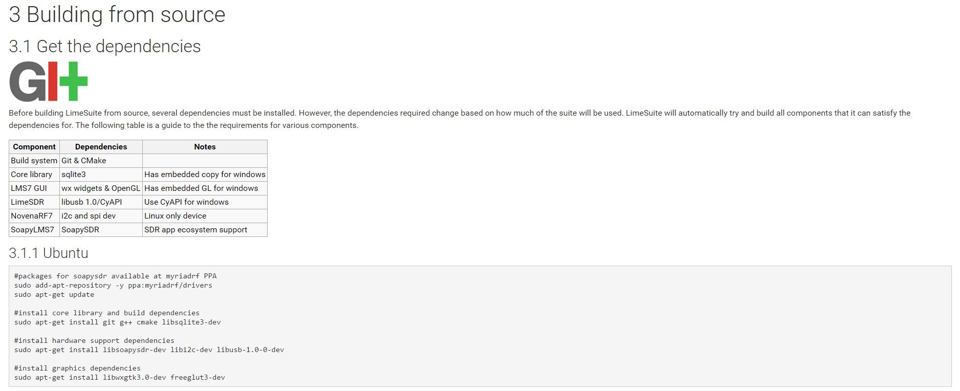

Sure do…Here’s why (see screenshots):
From this link ----> Lime Suite - Myriad-RF Wiki You get instructions to do the following to set up LimeSuite:
…Then…
…Then…

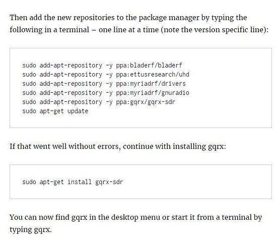

After that’s complete, I tested LimeSuite to make sure it ran…It did successfully. So then I did this:
…And that’s how I installed everything in 16.04. Pretty sure that’s how the issue started…
