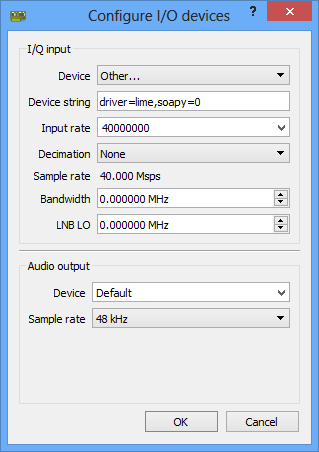

On my computer with windows 8 , Gqrx works well with AirSpy .But if I run Gqrx with driver=lime,soapy=0 it crashs. My LimeSDR works well with SDR-Console V3 . What’s wrong with Gqrx with LimeSDR ? Can Gqrx run with LimeSDR on windows ?
I would guess sample rate or bandwidth setting (that’s what can cause it to crash on linux), but I don’t run gqrx on windows, sorry.
Alex is right - - if you attempt to run GQRX on Windows and have the sampling rate less than 10,000,000 ( to make that 10 Msps) and the bandwidth set below 100,000,000 (to make that 100 MHz) then GQRX will crash either in Windows or under Linux. It’s a ‘known issue’ in SoapySDR and there’s been talk that it’ll be fixed at some point. So for now, use the following settings:
Device String: driver=lime,soapy=0
Input Rate: 10,000,000
Bandwidth: 100,000,000
Then it’ll play fine then and it won’t crash.
Thank you @martywittrock , I just make Gqrx work in windows with Input rate 40,000,000 and bandwidth : 0 ( default ) .It play fine and won’t crash
