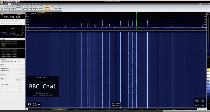

FWIW the problem with images is fixed! Am now compiling latest github code with the HF fix.
@SimonG4ELI Great Job, look forward to testing itā¦
FWIW - LimeSDR v1.2s hardware, 65MHz bandwidth, 80% FFT overlap, 320 million FFT bins (points) / second using GTX 970 for the FFT.
Impressive Simon. Quite a bit of video card power is needed for that much span and quite a bit CPU.
CPU is not too bad, but you do need a CUDA card for this sort of FFT
. You donāt have to use such high resolution, normal resolution would result in 80 million FFT /second at 65MHz bandwidth.
