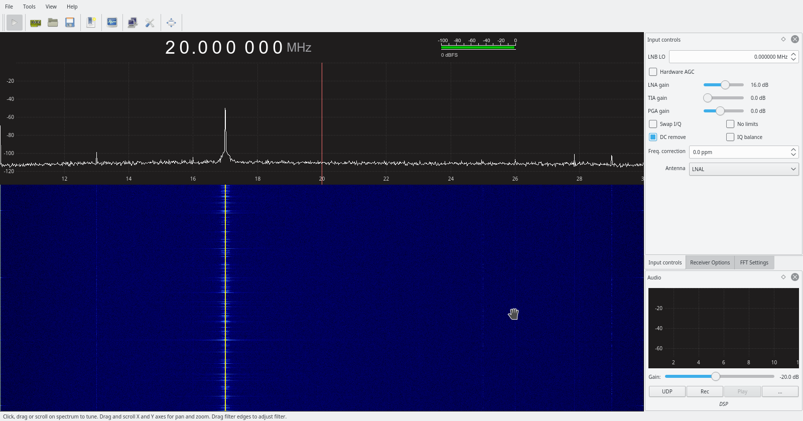

For the HF tuning, as anyone put in a test tone and checked in the spectrum where it shows up? Here is a 17 MHz tone showing up correctly in GQRX (my laptop was struggling to keep up) . The tuning checks out, 20 MHz center frequency was requested, the LO is set to 30 MHz, and the NCO is set to -10.
That must be WWV on the left edge …
