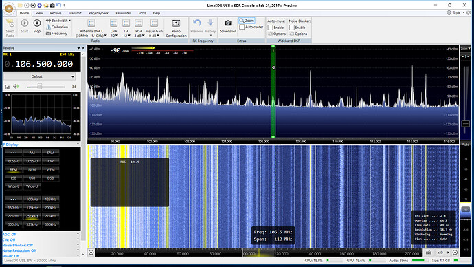

As a reference, I’m using a local FM broadcast station here on 106.500. I have a little scanner with rubber duckie directly next to the Lime, to make sure there a signal at that spot in my lab. The scanner receives that station S9+. See screenshot where it’s evident Lime hears NOTHING. And look across the band. There is a whole lot of noise all over the place, but nothing that looks like a 250kHz wide FM broadcast station. And there are (in reality) MANY bcst stns in that part of the spectrum.
The screenshot also shows I’ve got my other settings (gains, sample rate, etc) set to exactly match Simon’s personal setup, from a screenshot he kindly posted here for Paul a few weeks back when he was helping him get up-n-running on Console.
