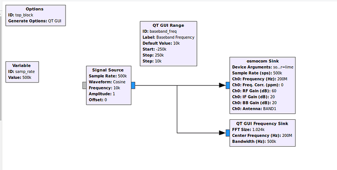

I have a LimeSDR-USB v1.4s. I’ve been trying to experiment with transmission using this simple flow in GRC:
With the centre frequency at 200MHz, using the GUI slider I can generate a tone at 200MHz +/-250kHz.

- On my desktop PC with USB 2.0 ports, my flow seems to freeze when I try to transmit, and I just get the centre frequency visible on the spectrum analyser. Moving the GUI slider doesn’t update the frequency. The GUI frequency sink also freezes despite moving the slider. This doesn’t happen on my laptop with USB 3.0 ports.
- On my laptop, there is a long delay (about 16 seconds) between changing the tone frequency using the GUI slider and the RF output being updated as seen on the spectrum analyser.
