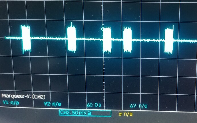

Dear All,
I get a bad behavior about transmit signal with gnu radio. It is nearly similar with you maybe.

In programming section with LimeSuiteGui I uploaded the image 19.4.
when I try to do a quicktest I put frequency central equal to 120Mhz
when I analyzed the spectrum everything seems ok. I was also able to check that the exit was always continuous.
Also when I run basicTX all seem good (data rate is constant)

But when I use gnu radio , I have discontinuity on the output
Have you got one idea?
