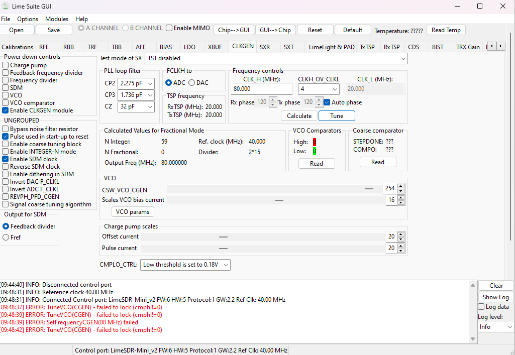

Hi, I’ve been trying to use my limesdr mini v2 and I always get “TuneVCO(CGEN) - failed to lock (cmphl!=0)”, I’ve tried to update the device using LimeSuite --update and it says it’s already at the newest version of the gateware:
Connected to [LimeSDR Mini [USB 3] 1D90ED1C8222F5]
Existing gateware is same as update (2.2)
Using the CLKGEN tab on LimeSuiteGUI, Calculate and Tune yield the same error…
UPDATE: If I enable “Charge Pump” on the Power Down Menu, the Tune works and the High Vco Comparator turns to 1… But the issue still remains if I disable that option or if I use any software to access the device…
Is it possible to ‘‘fix’’ the device ? Thanks! All help is welcome!

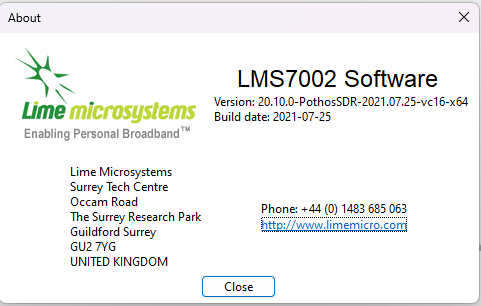

What is the version of your LimeSuite?
Its version 20.10.0 on this Windows machine, I think its the latest release from PothosSDR… But I also have LimeSuite 23.11.0 on my linux laptop…
version 20.10 does not have support for LimeSDR Mini v2, it has been added since v22.09.
Does the CLKGEN fail if you use LimeSuite 23.11?

Yes, same behaviour on LimeSuite v23.11…
