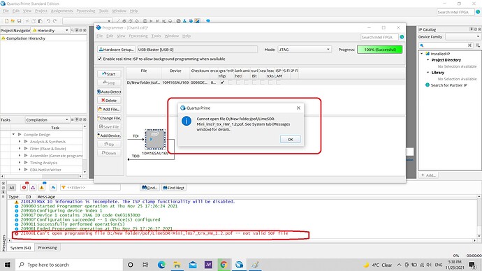

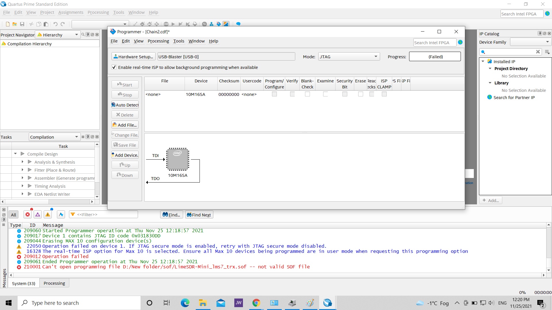

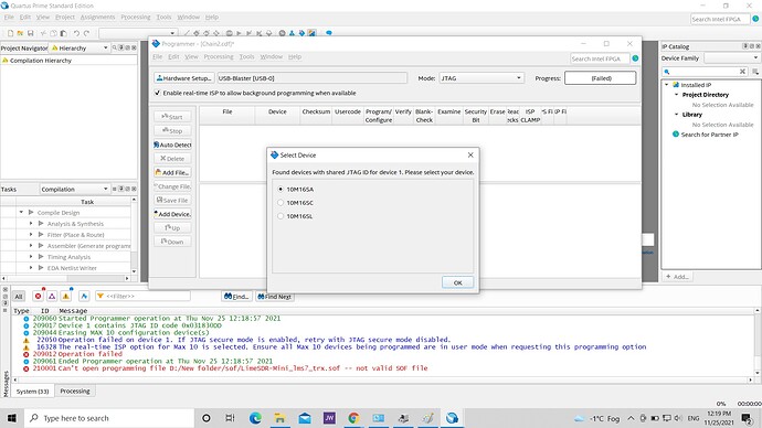

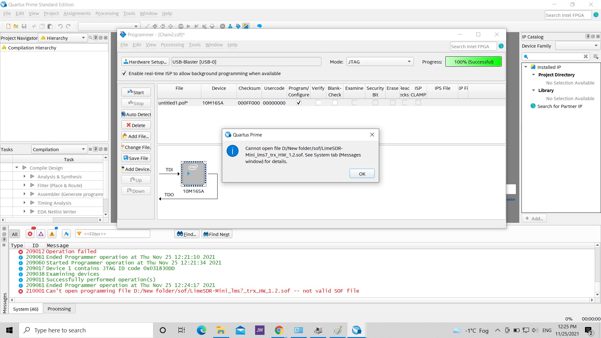

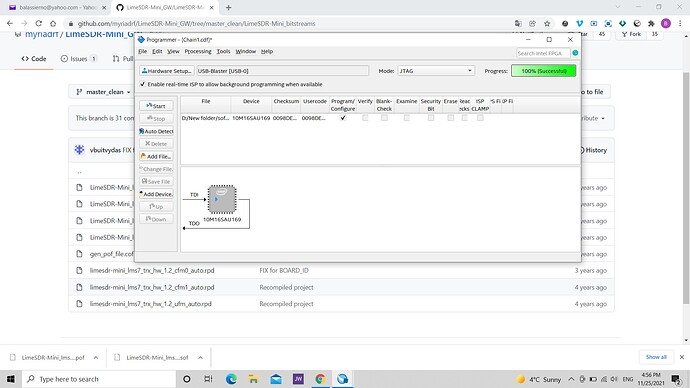

Hello . I returned . The programmer arrived and I connected to the software, it automatically detects but cannot write. Now is it possible that the Quartus software is a demo?
It does not accept either the .sof or .pof file

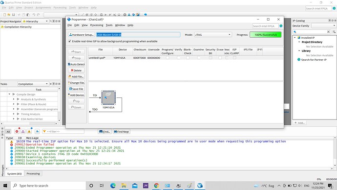

On the menu: EXamine can select and go up to 100 percent.
Once I managed to make a menu: check, but I didn’t succeed.
with the file I managed to make and the led started to flash with red-orange as it comes from the manufacturer
But I couldn’t write .pof files.
If I remove the Lime sdr from the USB port and insert tagain, the LED it does nothing
I will try to download the free version of Quartus prime lite 15.1

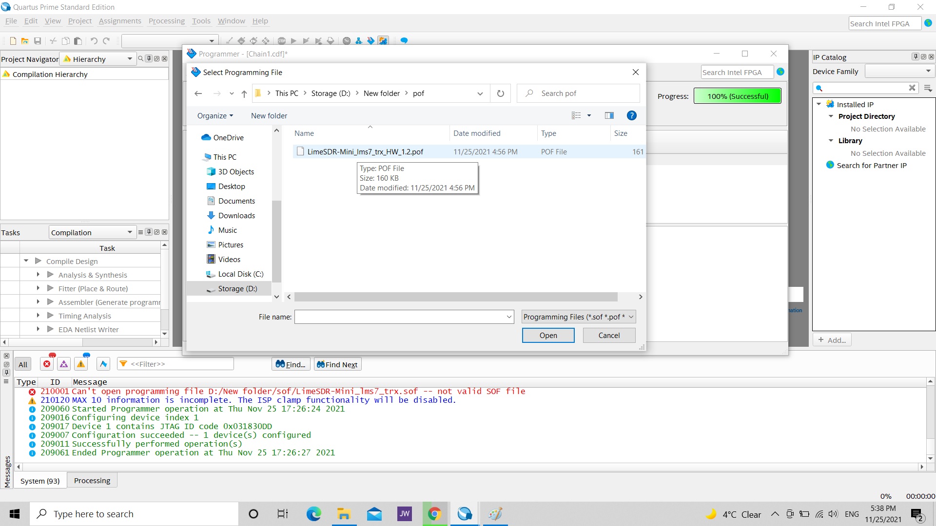

It’s normal, when you use a .sof file, the program is stored in RAM, so it’s lost when you unplug it.
To keep the program on the board you need to upload the .pof file.
And to upload the .pof the board needs to be programmed with the .sof first.
So what you need to do :
1- Upload the .sof file and keep the board plugged in
[quote=“Baer, post:26, topic:6803”]
[/quote]it’s fine.
the problem was that where I downloaded .sof and .pof files was not ok. that is, the size was the difference.
I downloaded what you posted on the forum and it was ok.
Now it also loads .pof files but it goes a bit slow but I have time to wait.
