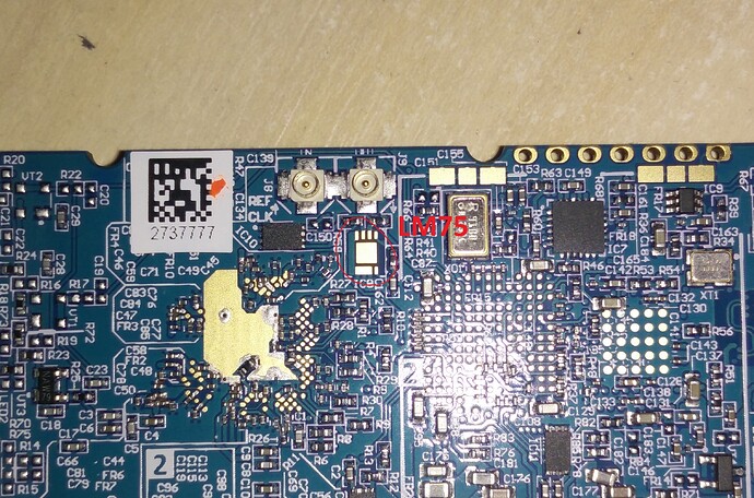

And about the “Read Temp” button in Lime Suite GUI. I had found that is temperature sensor in unpopulated. So it turns out that these readings are not true.
You may try to check temperature through Modules > Board controls > Labes > LimeSDR Mini and click Read all. In my case it shows -1.
Here should be that IC that measures temperature.
