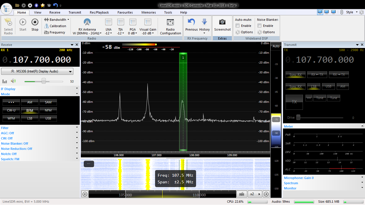

Stopped the radio, unplugged it, plugged in second Mini, added its definition, once again tuned to the local station only to have a different looking spectrum. Checked over SDR Console, cant find any differences in the settings for each of the definitions or settings for each radio.

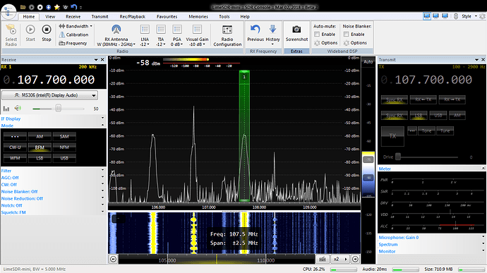

Here is the first LimeSDR Mini
So as can be seen, the noise floor of one of the LimeSDR Mini’s is 30dBm or so higher than the other and 23dBm of the Airspy.

Looking at the waterfall for “first LimeSDR Mini”, I see lots of horizontal lines, which could be a symptom of dropped USB packets (which would manifest as a raised noise floor). So my question would be were all other USB devices disconnected, and was the same USB port also used for the “second LimeSDR Mini” image.
Other than the wireless mouse and keyboard using a separate USB port, all LimeSDR tests (and resultant screen shots) were done with the same USB3 Port, same USB3 Extension one plugged in at a time. The Airspy was plugged into a different USB2 port with its own USB A to USB Mini cable.
