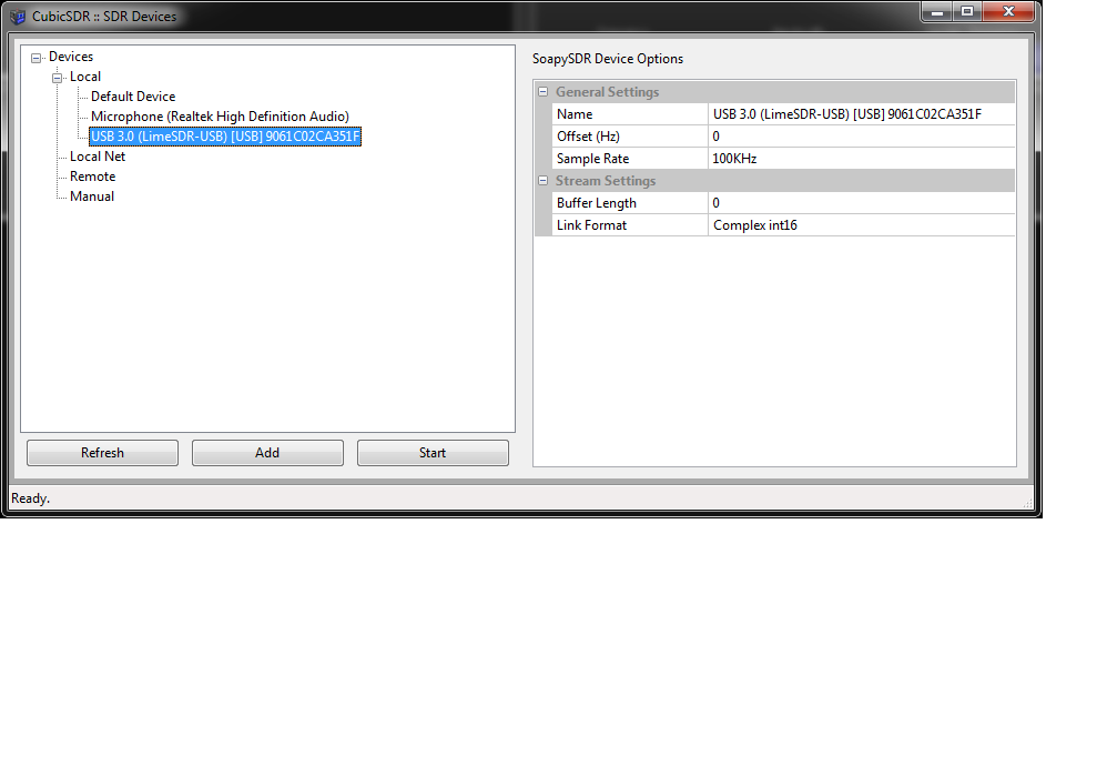

I made a test with CubicSDR software with low sample Rate (100KHz)
In this configuration the LED1 turn on green but i have no data stream.
