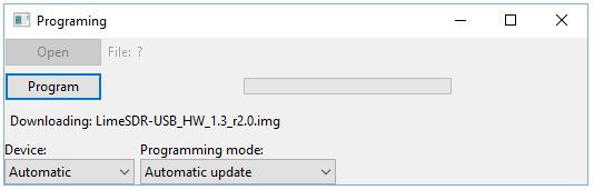

Next I open the Programming Module.
Next I click Program and get this>

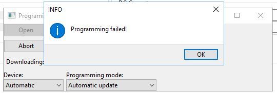

When I clear the INFO dialog box, I see this>
It looks like the download failed?
Also there are several image and rbf files listed at the moment. I would have thought that the img file that the programmer was trying to use would be the latest which is 1.3 r3.0
Does the Programmer do img then rbf for the FPGA?
Sorry for all the questions. I used to updating my OpenHPSDR stuff which is one step using using an rbf.
The Programming Interface in Windows is a little weird, but try the programming again in Windows…When a command-line box pops, leave it alone - it’s downloading the .img file from the internet, then it downloads the .rbf file from the net. After that, it begins to program your LimeSDR with the files that were downloaded. I had this ‘failed’ condition happen to me, too, but download the latest Pothos install that was (I think) posted last night by Josh. Again, do that and try the programming again, but leave everything be while it’s downloading the files…then you’ll see it flash them appropriately.
