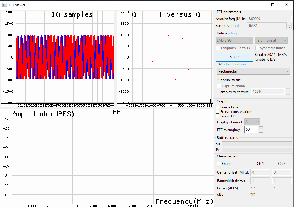

Could you be more specific on this, please. Could you post some print-screens of the results.
Hello Zack,
I followed the steps mentioned in section 4 of the below guide.
When the input source was ADC, I got the following in the FFT viewer
When the input source was test signal, I got the following in the FFT viewer
I have a doubt whether Iam doing things properly or not. As you can see that in both the screenshots, the Tx rate is 0. For your information, I havent used any antenna. Also, I have only performed steps from 4.1 to 4.7 of the guide mentioned above. Please let me know why the transmission is not taking place. Also, why these FFT viewers are showing different behaviour compared to that shown in the guide mentioned above.
