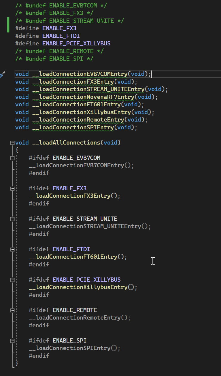

Hi
I am hardly working to get it up and running.
I have digged in the example BasicRX.
It tries to connect to the device in this function
  • Registry implementation
    std::vector ConnectionRegistry::findConnections(const ConnectionHandle &hint)
    __loadAllConnections();
    std::lock_guardstd::mutex lock(registryMutex());
    std::vector results;
    for (const auto &entry : registryEntries)
    //filter by module name when specified
    if (not hint.module.empty() and hint.module != entry.first) continue;
     for (auto handle : entry.second->enumerate(hint))
         //insert the module name, which can be filtered on in makeConnection()
         handle.module = entry.first;
         results.push_back(handle);
    return results;
Here the registryEntries has two elements. The inner for is never entered.
So no connections.

Hi
I am trying to get it to work
Please help me.
In the built in connection I find something strange.
The macro ENABLE_FX3 should be enabled. It is not ..
I forced to be and here
the __loadConnectionFX3Entry()
is not found. Is there a missing library ?
Help
Pietro
The ENABLE_FX3 is not enabled, because the CMake couldn’t find the FX3 SDK location, even though you have it installed, Windows does not provide a way to automatically detect it. You have to manually set the FX3 SDK path in the project’s CMake config. For example like this: LimeSuite/cmake.yml at master · myriadrf/LimeSuite · GitHub
Hi
Thank You.
I am not founded in the make files. But I saw the file for this connection is not in the project. So I manually added, together with the library path and additional directory includes in the project properties. It is working. I have now some version mismatch in the console. I am happy to go on.
Thank You
Pietro
