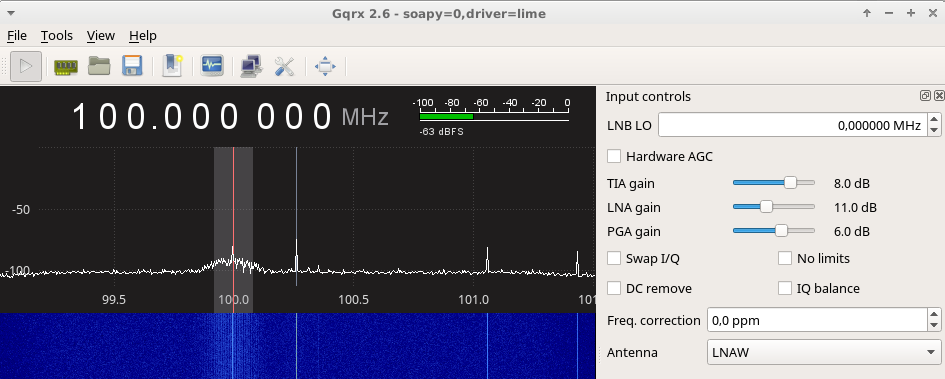

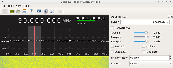

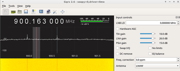

in your screenshots LNA gain is set to 0!
Hello, thanks for reply. LNA gain makes this situation a little better
But the oddity is that I only see data at frequencies close to 100 Mhz and still almost nothing on others
I’m newby to sdr and do not understand. Is the some calibration required to receive the signal?

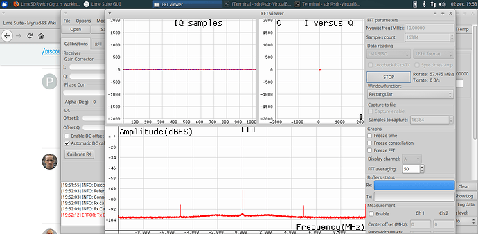

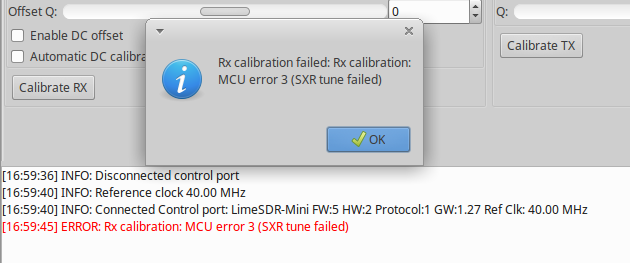

Calibration with LimeSuite is now working properly. Sometimes it gives me error 3 and error 5
TX calibration is not working too

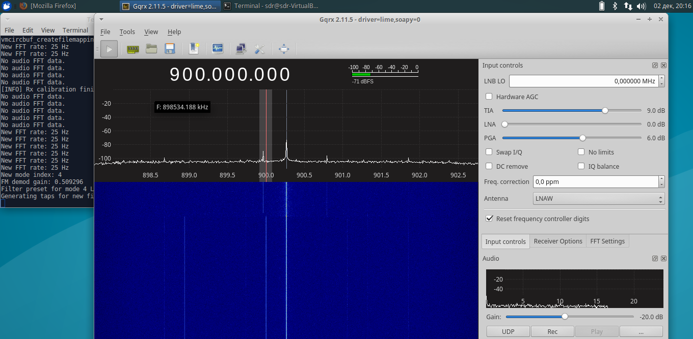

Thx for fast reply. I repeated your actions in the program. But received signal is also very weak. When I use TIA, LNA and PGA gain in gqrx it just makes more noise, no signal.

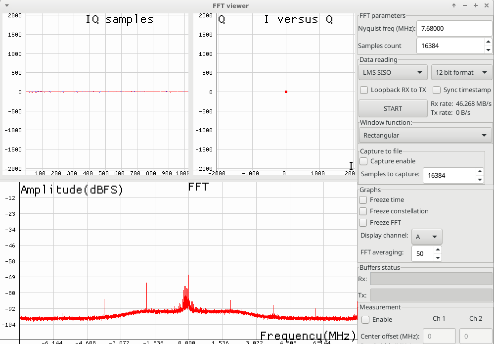

In LimeSuite test signal is weak too

This is gsm (just a noise)

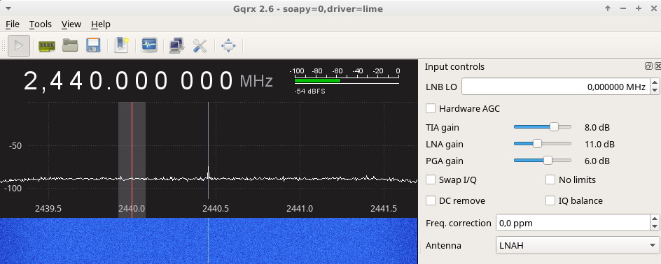

wifi

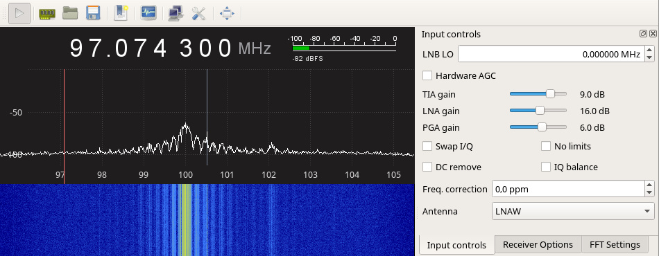

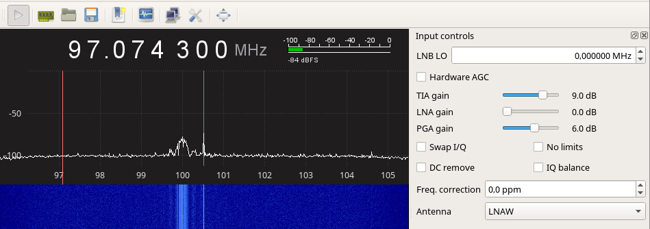

This is something in the fm, but signal very weak

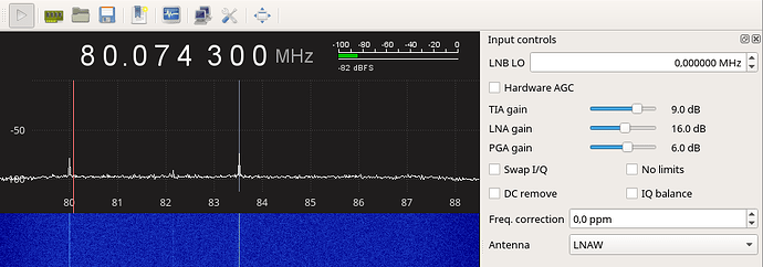

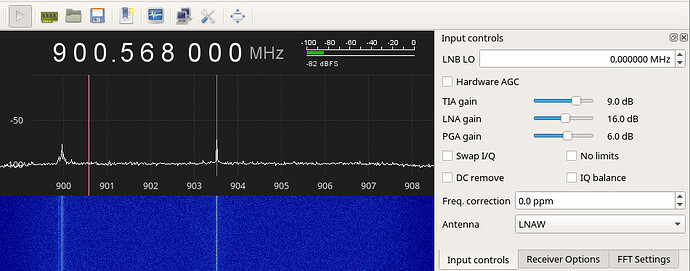

Some signal in 400 - 500 Mhz (noise leveling at center because large bandwidth)
All tests with antenna

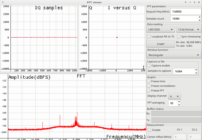

at 100Mhz you should have a HUUUGE noise signal tis is dead
100Mhz NO antenna connected
