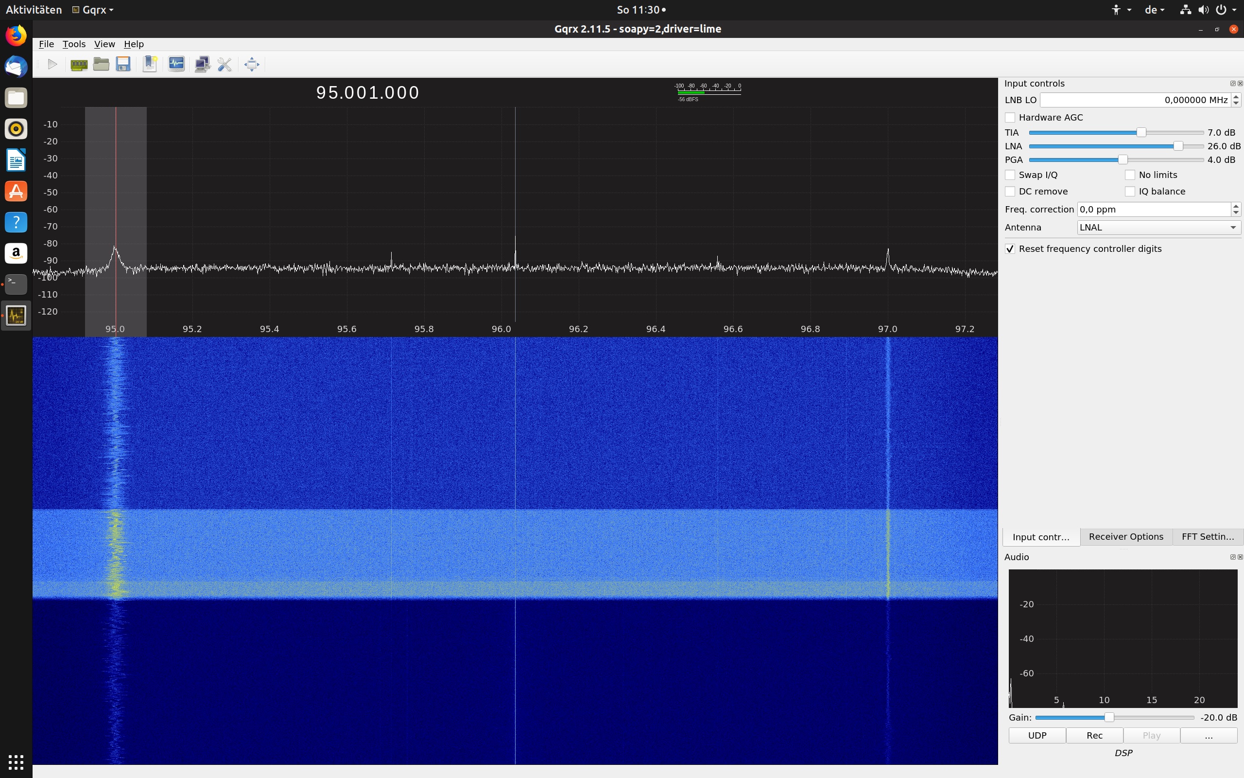

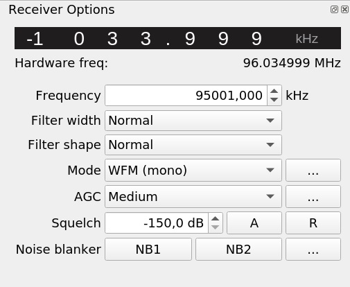

I also hope for a solution to my problem here. I recently started using a LimeSDR USB (no Mini) and also massive reception problems. Basically I try to receive FM radio only for the first time. With WFM Mono I can listen to music (poor quality), but with WFM Stereo I only have noise. The signal is obviously not very strong either. I tested both LNAL and LNAW with a different antenna cable and an ANT500. But it just doesn’t get any better. I tried this under Windows 10 and Ubuntu 18.10 (VMware) - exactly the same.
The LimeQuickTest is now successful (at the beginning failed at the last test probably because of insufficient power supply).
Do I still have to adjust anything on the LimeSDR (calibration, firmware, etc.)?
