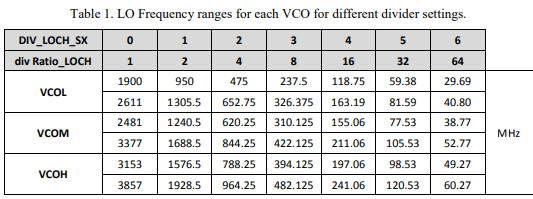

I have a signal at ~59 MHz (RX port). I can see it when I’m tuned to 60 Mhz, and can’t at 61 MHz. I noticed this is the range when VCO switch should occour (VCOH → VCOL):

calculate and tune to 80Mhz (VCOM is autoselected),
calculate and tune to 60 Mhz (VCOH is autoselected).
calculate and tune to 61 MHz (VCOM!!! is autoselected)
