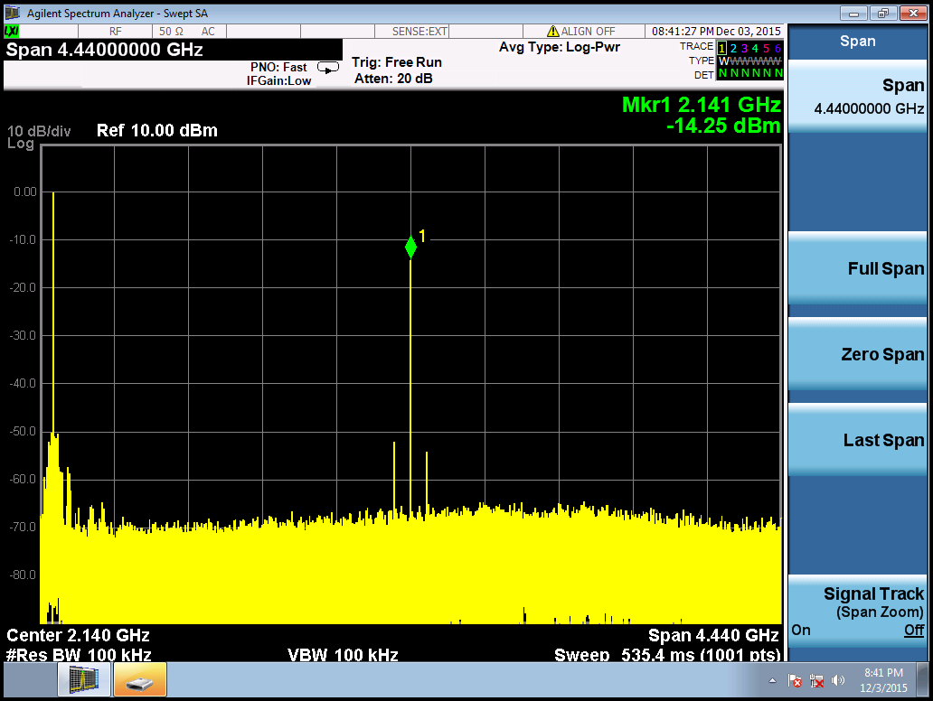

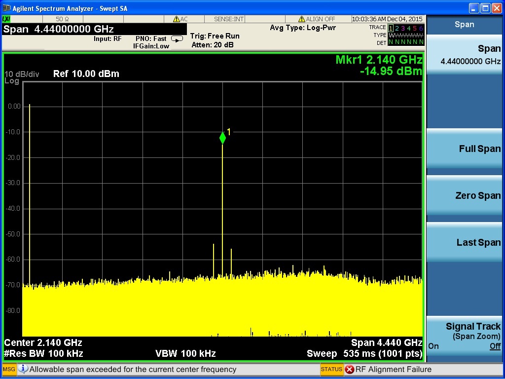

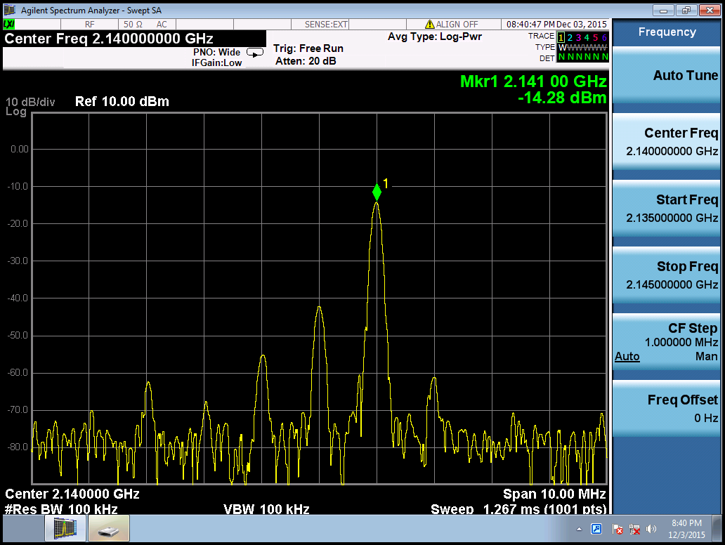

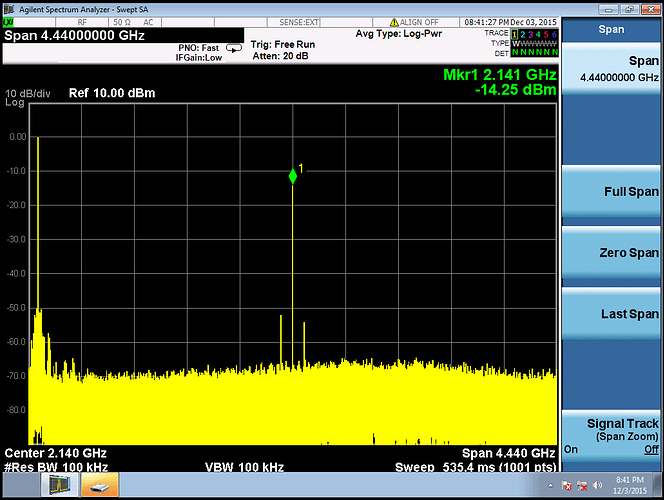

Here is the spectrum of the TX output,Could anyone help me to find out why the background noise is upraised, what caused this phenomenon and why my signal have so many unwanted tones? Thanks.
FYI. Post from open source forum:
I had quick check on your GUI settings of LMS7002M chip.
My first assumption is that on your Evaluation boar Crystal Oscillator reference clock is not 30.72MHz, but 52MHz.
So let’s first check if that is the case. In order to do so, please load GUI setup file attached ‘Test_Lime_52MHz.ini’.
Go to SXT/SXR page, select B/SXT option on the top right side of GUI.
Type in your wanted frequency and click ‘Calculate’ & ‘Tune’. If everything is right, you should get the message
in Log field of GUI at the bottom saying “CSE_VCO selected 110” (the number depends on frequency).
And of course you should see your signal on Spectrum Analyzer.
In order to generate your wanted CW 2MHz tone signal (at 2142MHz) from your LO (2140MHz) here are the step you need to take:
TxTSP page:
- NCO (FCW) type 2MHz in one of the fields, chose that field and click ‘Upload NCO’
- TSGMODE select ‘DC Source’
- Bypass uncheck ‘CMIX’
- Input source ‘Test Signal’,
CLKGEN page:
- CSW_VCO_GEN 213 (look for the value that gives exact wanted NCO generated signal, in your case 2MHz)
Please keep in mind that after starting GUI it is needed to run CLKGEN Tuning Calculation by clicking ‘Calculate’ and ‘Tune’ buttons on CLKGEN page.
In case you want to send digital signal from Baseband set on please, follow these steps:
TxTSP page:
- Input Source set ‘LML Output’
- Bypass check ‘CMIX’
- CLK_H (MHz) 61.44MHz gives 5MHz bandwidth of external W-DCMA
20 MHz gives 1.5MHz bandwidth of external W-DCMA
Hope that helps you to move on further work.

Thanks,I have checked the output of the crystal oscillator, It’s 30.72MHz rather than 52MHz.
When I used the file you provided and changed the reference clock for 30.72MHz and set the CW 2MHz by “LML Output” ,then clicked “Calculate” and “Tune” buttons, now the spectrum seems more normal than before.
But it still has some strange phenomenons sometimes,like the pics attached, they always occur just for 1 or 2 seconds. I’m confused about what caused these phenomenons.
Hello Taeyeon,
Try to change on SXT/SXR page in the block ‘SXT/SXR controls’ Value of ‘CSW_VCO’ till the performance gets stable.
Make sure on the top bar of GUI in the block at the right ‘Configuring Channels’ option ‘B/SXT’ is selected.
Thanks.
I have tried as you said,but it didn’t work. The spectrum will still dither sometimes.
Hi Taeyeon,
In this case it would help to start looking ant the digital side of the platform.
It could be that the dithers are coming from the baseband side. Could you please describe
what platform are you using? Is it MyriadRF-1 board with Zipper connected to FPGA, or UNITE7002 board with Stream board? Or is it your own board design? Once we have full picture of the platform, then we can start tracking where the bug is coming from. Thanks
Since I know form the other forum conversation that the BB platform is your own design and you are using UNITE7002 boars. Let’s first check if there problems is caused in the settings of LMS7002M or in digital interface on your board.
Please load uploaded GUI setup file. You should see signal as it is on pictures attached. The ResBW of Frequency Analyzer is 100kHz.
For GUI setup, please copy this text to new txt file. and change it’s extension from .txt to .ini

Hi lgnas,
Thanks very much for your help.
I’ll try it later then give you the result.
Best regards
Hi, lgnas
Here are the results of the test file. It looks the same as your result.
Does it means that the problem could be in the digital interface of my own board?
Thanks.
hi Taeyeon,
Yes, it is clearly the issue of digital lines is somewhere on your board. To find which data bit can cause the issue, I suggest to probe them one by one while you sending let’s say CW or W-CDMA signal and see if the data bit you are probing is stable or it introduces any unexpected noise.
Hi Ignas,
I have tried as you said, I found the TXCLK shows some unexpected pulse at the out put of the SN74AVC4T774, while my input signal seems OK. Could be this caused the dither of my spectrum? I tried to eliminate them, but it seems caused by the SN74AVC4T774. I will show your the waveform later. Could you help me to analyse it?
Thank you very much.
Hi lgnas,
Here is the waveform,the yellow line present the input of SN74AVC4T774 while the green is output.
Hi Taeyeon,
I see that same dither is also on the input of buffer SN74AVC4T774.
I think you have to analyze if CLK on your baseband side is working properly.
It might be something on the board is causing CLK line to dither.
As per my observation on your Evaluation boar Crystal Oscillator reference clock is not 30.72MHz, but 52MHz. So let’s first check if that is the case. In order to do so, please load GUI setup file attached
Type in your wanted frequency and click ‘Calculate’ & ‘Tune’. If everything is right, you should get the message.
