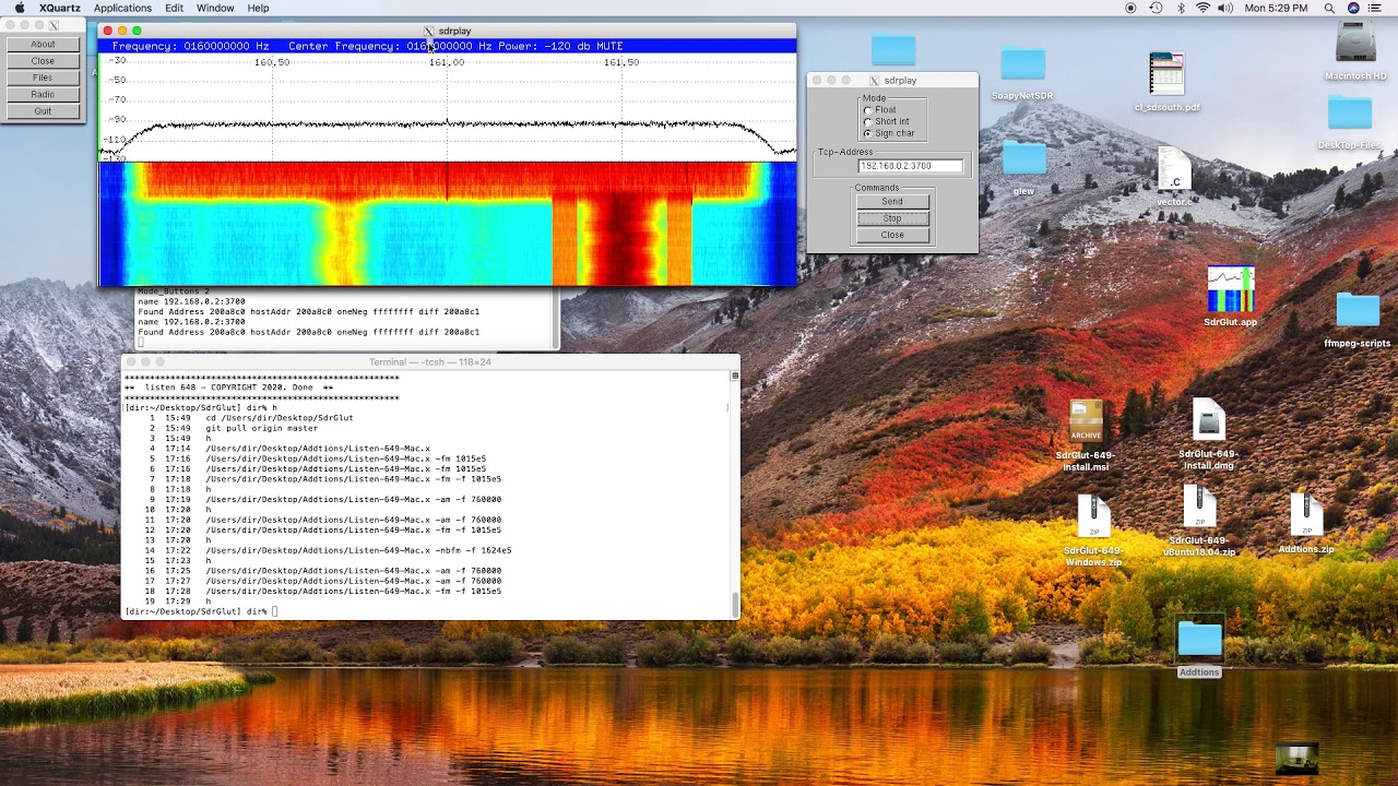

I made an addition to SdrGlut - you can now set the send sample rate and I fixed a bug in the send routine. Between my MacBook pro and the PI 4, I could not get the transmit to work. Between my Windows 7 machine and the PI 4, by setting the send sample rate to 200000 - it actually worked with a little delay in the sound and a little noise. Using my Hackrf One it was consistent, but the LimeSDR mini worked now and then. I think my LimeSDR mini is just about dead - it has been giving me lots of trouble. SoapyRemote, in the transmit mode, has minor problems on some system and major problems others. If you want to try you luck, clone a new version and build SdrGlut from source -

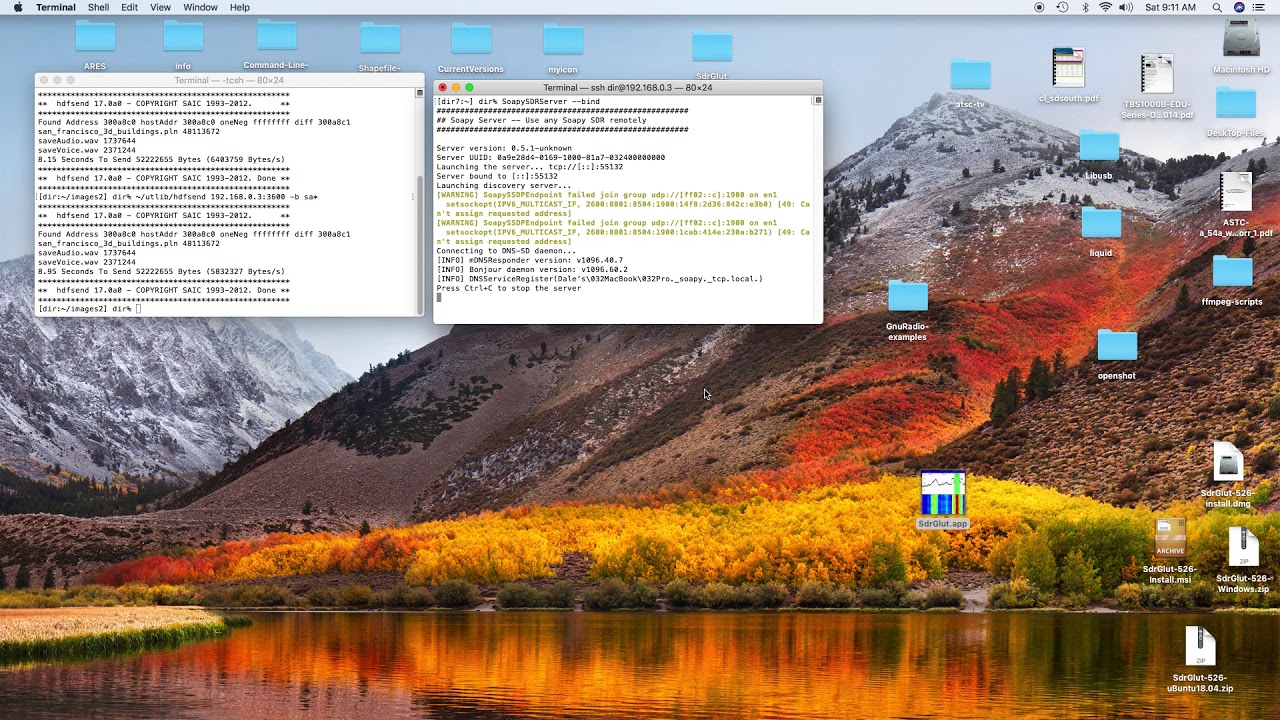

I looked into the source code of SoapyRemote and it is amazing clean. It the first time that I have ever seen operator overloading used to good effect. I can see where the problem should be, but it looks correct. He uses a alternate set of commands from what I use - may be they have bug in them - perhaps I can switch it to use the commands that work for me.
I make a video showing the problem on MacOS High Sierra and make a report at the Pothos User group.
It works for me now, MacOS High Sierra -> Ubuntu 20.04 and MacOS High Sierra-> Raspberry Pi 4. AM, NBFW, and USB all worked OK. I went into the SoapyRemote source code and I found that I was using one of the routines incorrectly. It was a one line fix. You will need the latest version of SdrGlut to try it.

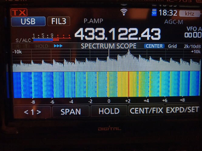

Wow, good work. TX works now! Just one small issue left. I’m receiving at 433525000Hz 200000 sample rate USB in SdrGlut my TX from Icom and it works well. Then I transmit from SdrGlut with default sample rate 400000. Its fine now RX in Icom. From now the RX in SdrGlut is broken.
The issue is, that both sample rates (RX/TX) has to be same for LimeSDR. When is the sample rate in Transmit changes, the RX in SdrGlut don’t get it and the signal is than distorted.
Does it work - if you set both sample rates to be 200000 ?
Yes!
