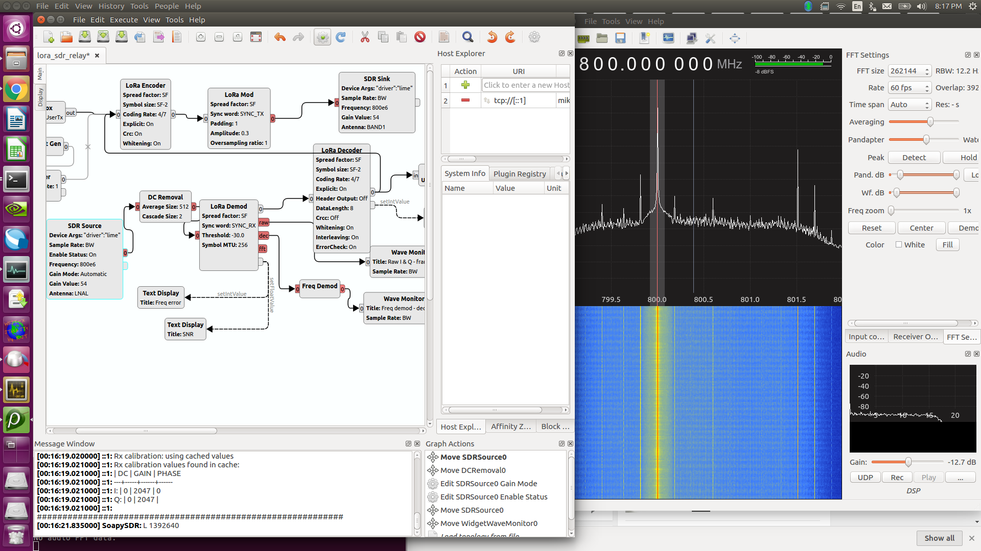

I at least have the LoRa Pothos SDR project transmit part working on my Linux box.
I am able to transmit messages, but the receiver section does not seem to be working.
I ran the PothosGui with the Lora project, transmit at 800 MHz and using the RTL-SDR was able to see the spectrum at that frequency, and as you see by the images, the spectrum is being used. I am just unsure why it is not receiving.
I have both receive “antenna’s” (little black ones) on each of the Rx low and Rx high.
The same frequency and gain levels are on both Source and Sink.
Images are attached.
