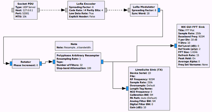

I’m new to SDR world and started learning with LimeSDR. I’m working on a project to implement LoRa modem with LimeSDR. But instead of pothos I’m using GnuRadio using gr-lora module.

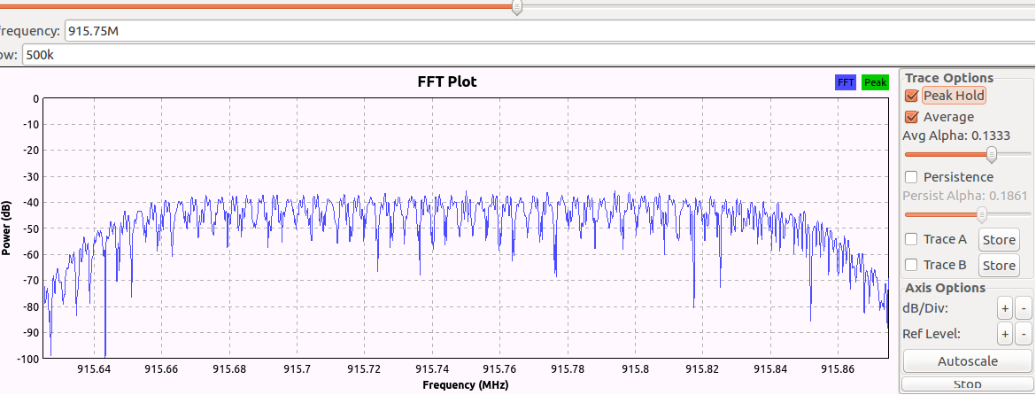

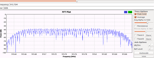

Now, problem is, Lime-TX side is working properly as observed from wx_gui_fft sink.

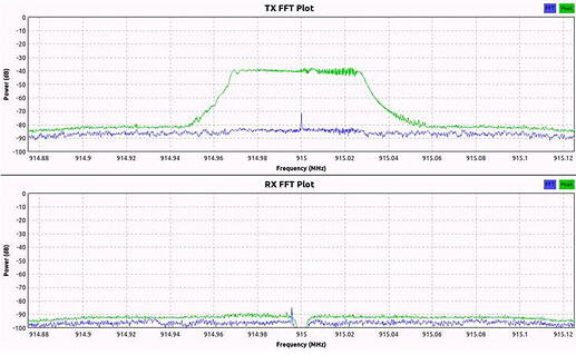

But my receiver Lime doesn’t receive any signal. I tried another grc just to capture the signal using LimeSource > WX_Gui_FFT. Nothing in the FFT.

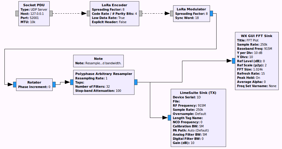

In original gr-lora projects, he used USRP, I just replaced the usrp block with limeSDR.
Can anyone share some ideas what might be the problem?
Just bouncing the post if anyone can help me or share some suggestions. As a beginner in RF world, I have no clue why there is no signal received by RX.
This is another test with different LoRa parameters : SF-7, BW-125K, CR-4, HeaderOFF. I’m using LimeSDR Mini for both TX and RX
Maybe you should first make sure that the signal is actually received through a program like sdrsharp / sdrconsole, etc.
And since this is a fortune-telling on coffee grounds, too many variables can affect the reception.
For example, I do not see your in / out channel settings.
I haven’t started gnuradio for a very long time, but my LimeSuite rx / tx gr block even looks different from yours. I have gnuradio from the PothosSdr kit.
