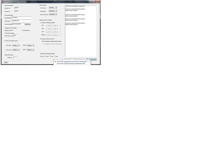

Neither LimeUtil nor the LimeSDR_Mini EEPROM programmer can see the device (but they can both see a working LimeSDR Mini).

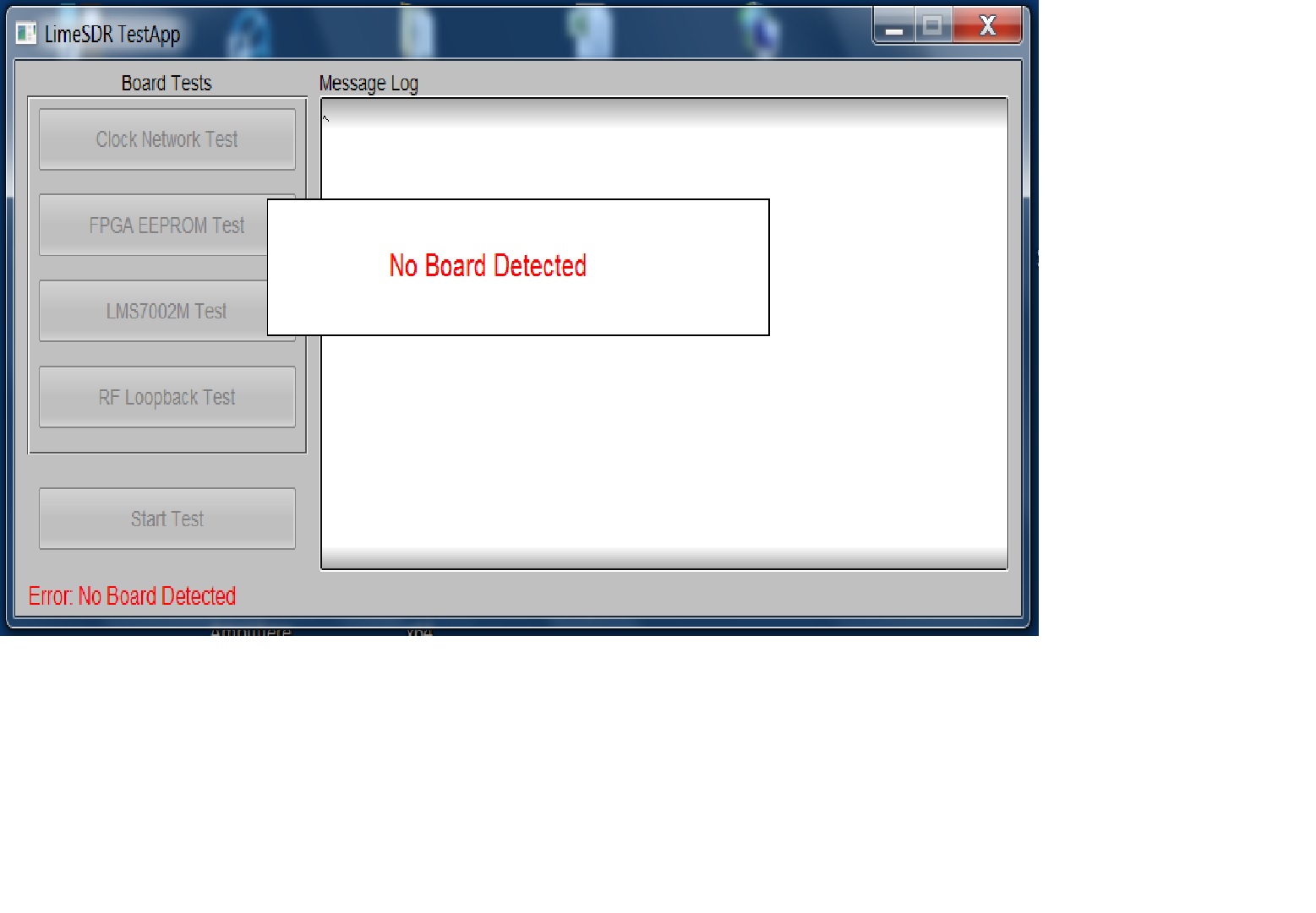

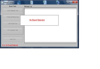

driver reinstalled and the test program will not work due to not found USB device.
Also 5V voltage controlled and USB-2 Hub applied give no change and the USB connection cannot be used.

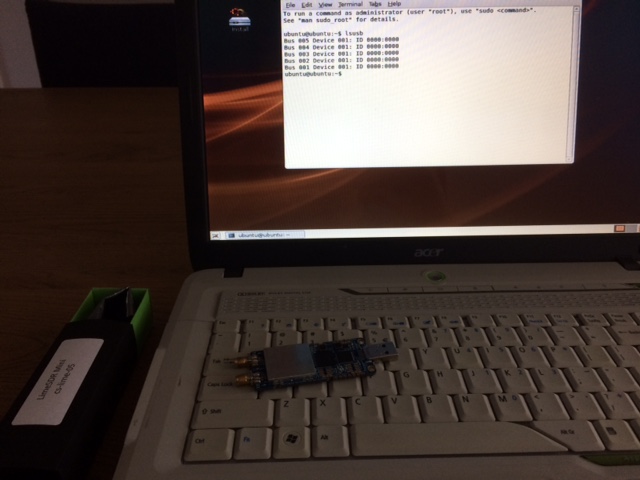

Could you boot your PC to Ubuntu using live CD and check it using lsusb command, please.
I did the LsUSB test with Live CD UBUNTU, the LimiSDR-Mini is still not found. See attachment photos.
