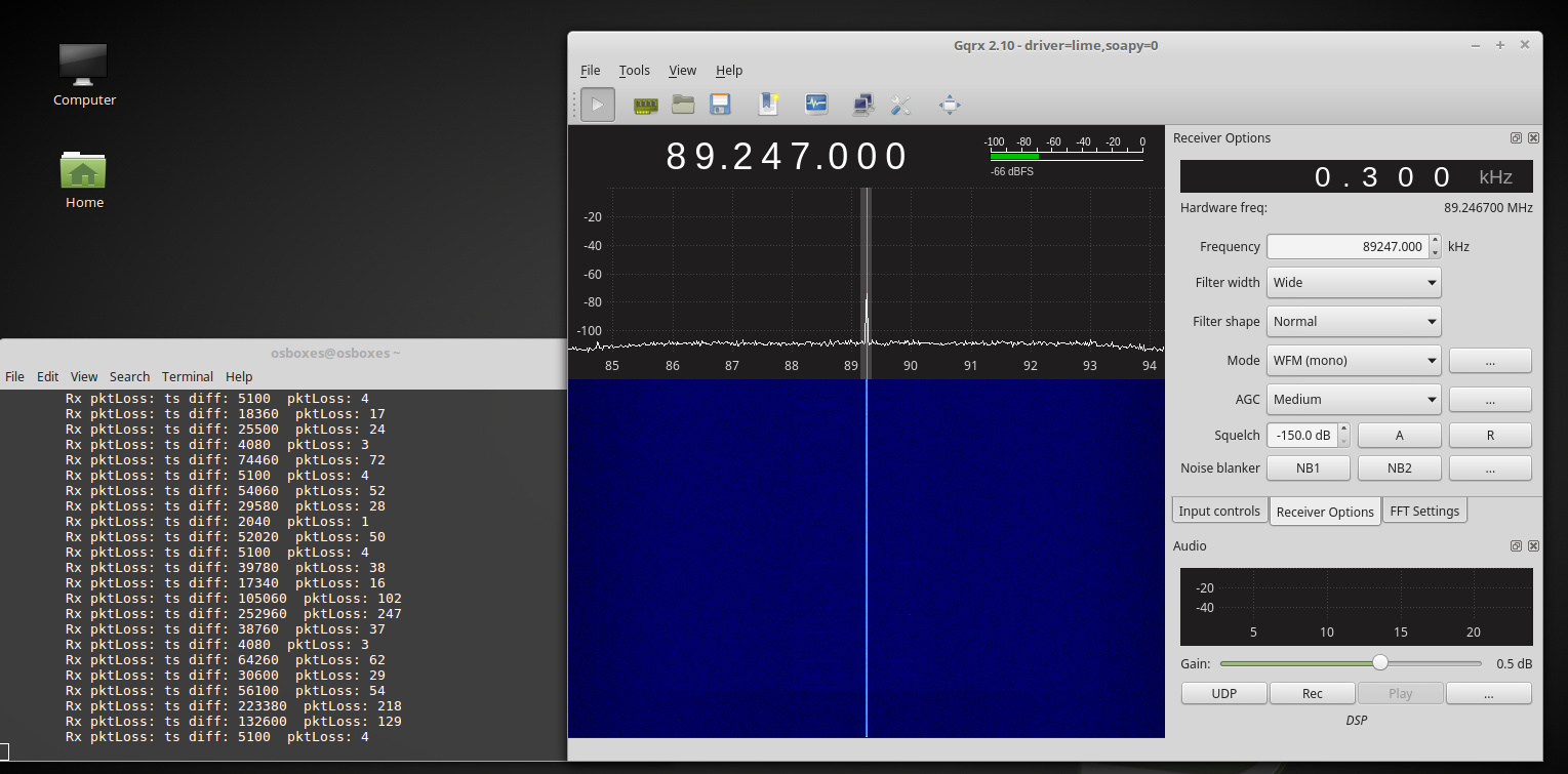

I’m having issue with using gqrx with Linux Mint, I can see the device through LimeUtil and SoapySDR, and can successfully launch the program with the given device string.
however I don’t see anything on the display as the picture shows, not even noise.
I’m new to the SDR thing, so it could be a silly thing that I am missing,
can any one help ?
Thanks

Thank you all for you commnents, turns out I didn’t push the start button ! (told you it would be silly thing)
anyhow, I did manage to recieve noise, but still didn’t get anything from the spectrum ,I’m searching in the FM space and got nothing but noise.
guess will have to keep investigating

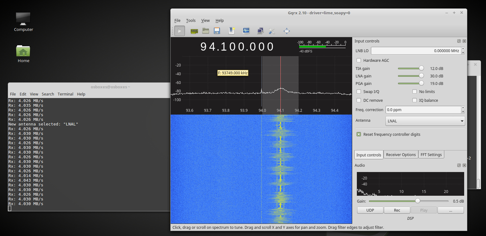

I’ve had reasonable success with GQRX on my lime usb. Due to my location I have very weak FM signal reception and have to max out my LNA, TIA and PGA gains. I’m using my LNAL ant and it rolls-off quickly below 100MHz. My I/O configuration is as follows: input rate, 1000000, No Decimation, BW 1.7 MHz, LBO LO=0. Receiver Options: Filter width/shape=normal, mode WFM, AGC=slow.
IT WORKED !
I managed to recieve an FM station with the LimeSDR with only 3 RX1 antennas connected.
not sure if it mattered, but I did a calibration in the LimeSuitGUI for RX.
