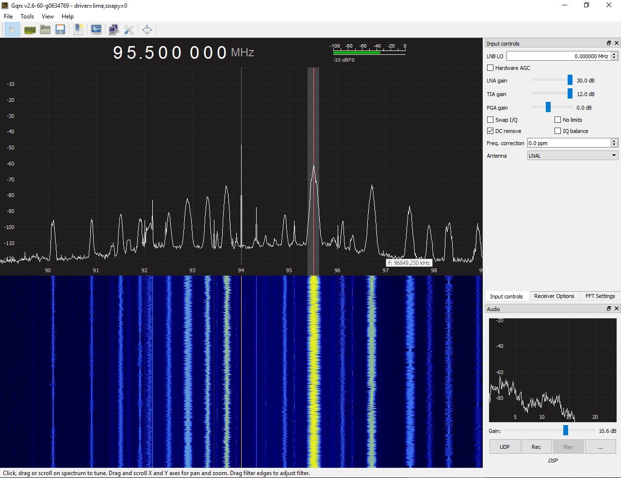

Marty,
I have GQRX running here under Windows 10. Screen shot of the FM band.
Also received the local NOAA station at 162.400
I used Pothos.
Mike, N1JEZ

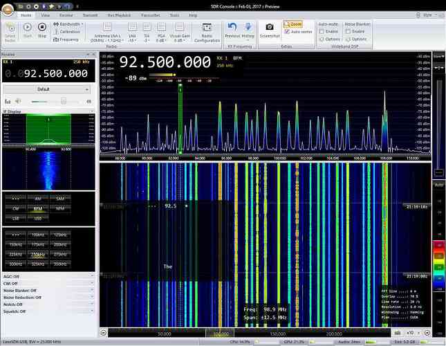

OK,
I now have the LimeSDR roughly as sensitive as the Airspy (user error here). What I don’t understand is the noise either side on this screenshot (below 90MHz and above 106MHz):
