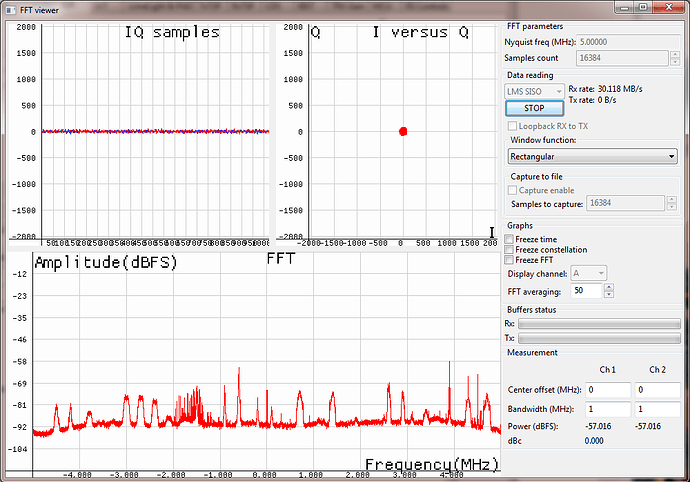

I’m now know that the spurious signals I see at 100MHz and the associated spikes above and below and at other locations in the spectrum are nothing to do with my plugin or the LimeSuite.dll. In fact, I also see these artefacts in the LimeSuite GUI tool when using their live FFT plot.
These don’t appear to be USB3 related (none of my other SDRs display these when using USB3 or 2. I’ve also tried using different laptops and desktops, all to no avail). It might be that I have a defective Lime Mini, although others also report seeing these artefacts. The investigation continues… They’re annoying and a little off-putting with respect to the Lime SDR.

What happens in the Lime GUI FTT Plot if you change the RX Lo frequency in small e.g. 100 kHz steps . Does the interference remain at 100 MHz or is it shifted by multiples of 100 kHz?
Hi Cornie,

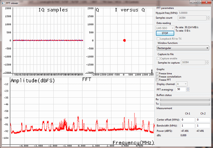

Some screen shots…
The first starts with the LO set at 101.00 Mhz (to avoid being at the centre, the spurious signals can be seen at the -1 marker), then 101.10 MHz, then 101.20 MHz and finally a bigger jump to 101.50 MHz. The spurious signal appears to stay at 100 MHz.
Have you always been selecting 10 MSPS ?
For troubleshooting, at least until you have narrowed down the exact cause, I would try and avoid sample rates that are factors of 100 (MHz), so 1,2,4,5,10,20,25 or 50 MSPS.
Is the effect reduced if you select a sample rate of say 12MSPS ?
Oh, and is there a similar spurious signal at 90MHz, 50MHz or 200MHz or is it just at 100MHz and nowhere else ?
