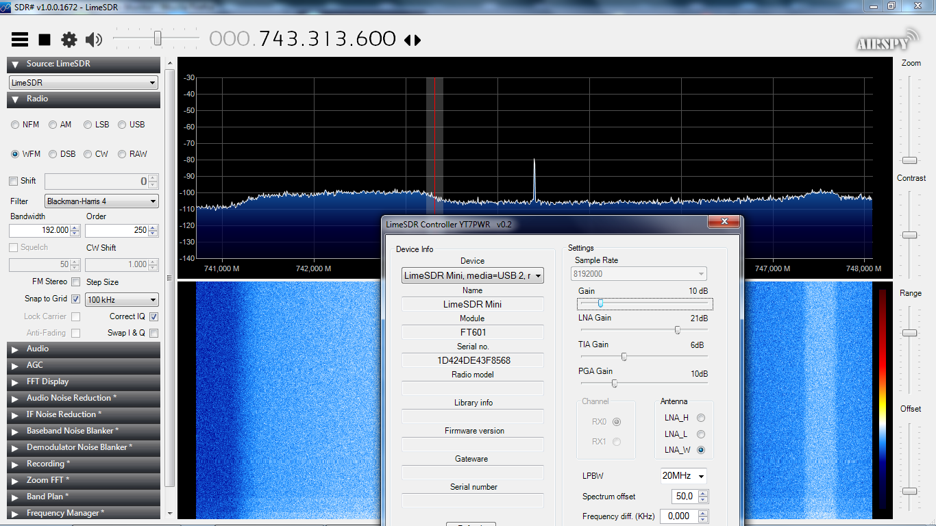

thanks Goran: it seems it works!
the large hump on the left is the 2MS/s DATV beacon while the smaller one on the right (~747.5MHz) is a 333KS/s DATV signal.
the spike in the center should not be there! the “Correct IQ” feature is useless.
now I have to try to enlarge/expand the vertical scale so that I can easily read 1 dB…
