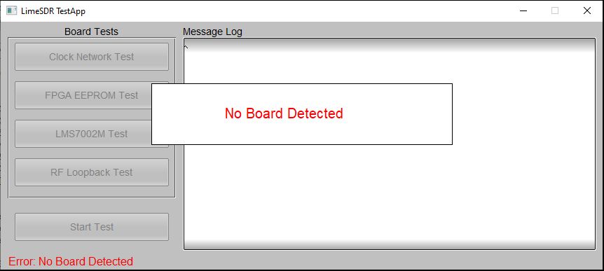

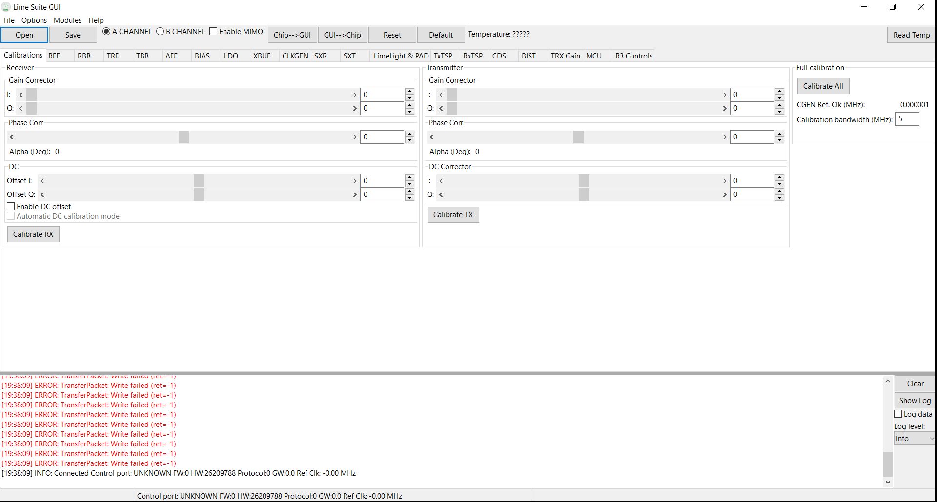

LIMEsdr mini V1.1 no board detect in LimeQuickTest

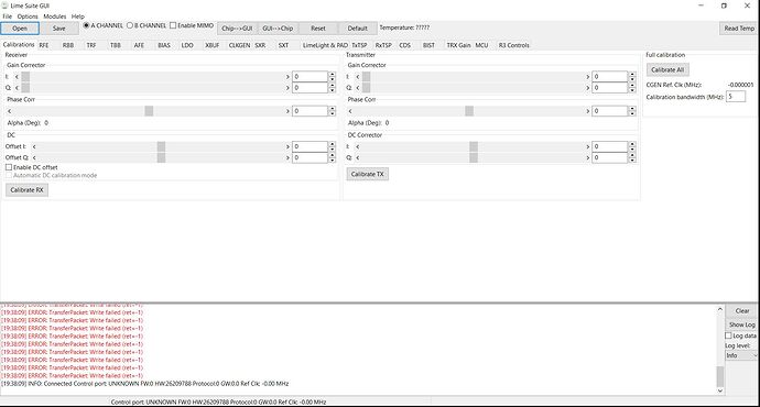

Hi i had a Limesdr v1.1 not working after installation.I got it working for a while in 2018.
Please any help. Very tnx in advance.

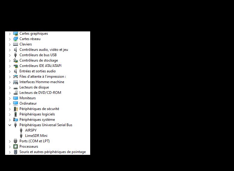

After installation that what i have in the Peripheral Manager
But
Regards
Sid
Sri i forgot to say it but i have a solid red led on the board.

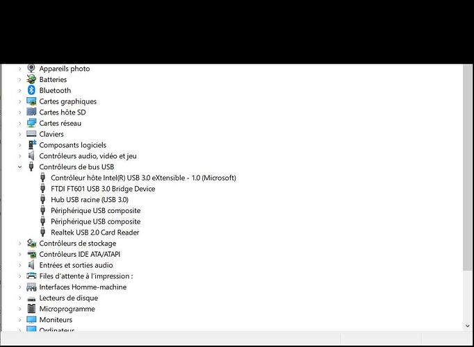

Hi everybody.
I reinstalled the drivers FTD3XXDriver_WHQLCertified_v1.3.0.8 then Windows-drivers-master and that what i have:
I still have a solid RED Led.
Regards
Sid

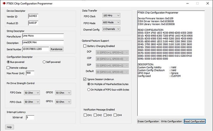

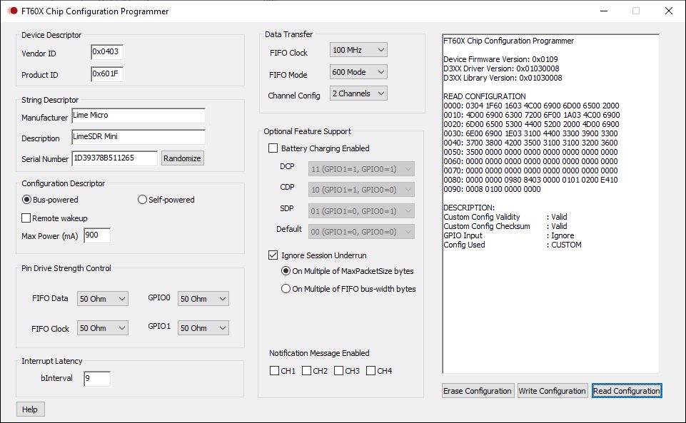

Hi @Sid,
problem looks like similar to this thread. Check FT601 IC configuration as described here
Hy VytautasB.
My configuration is the same as describted above
Seems like that i should do as Rachid & 9H1LO did.Change the FT601Q Chip.
