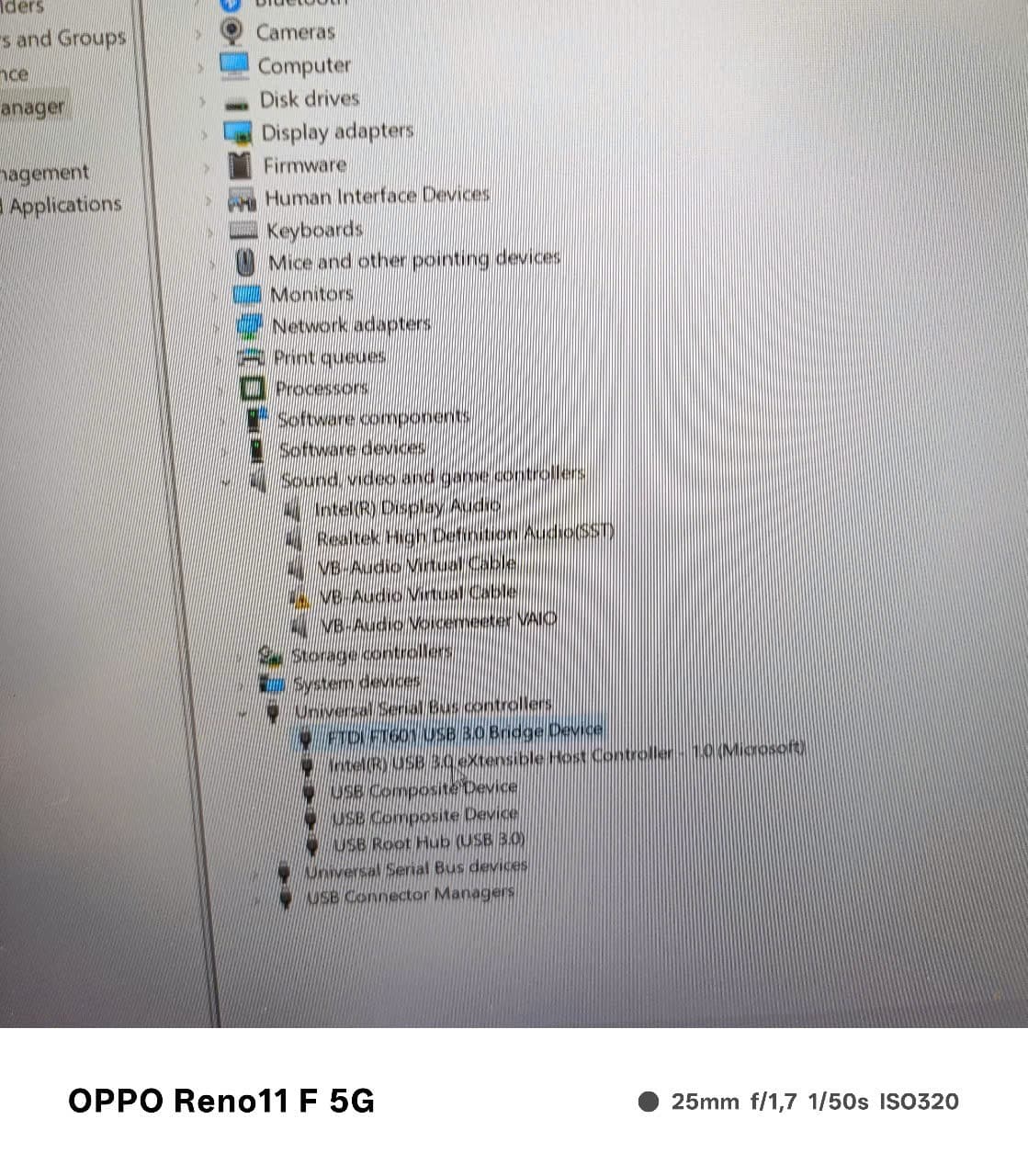

Hi, when setting up connection with computer it recognizes device but can not exploit.

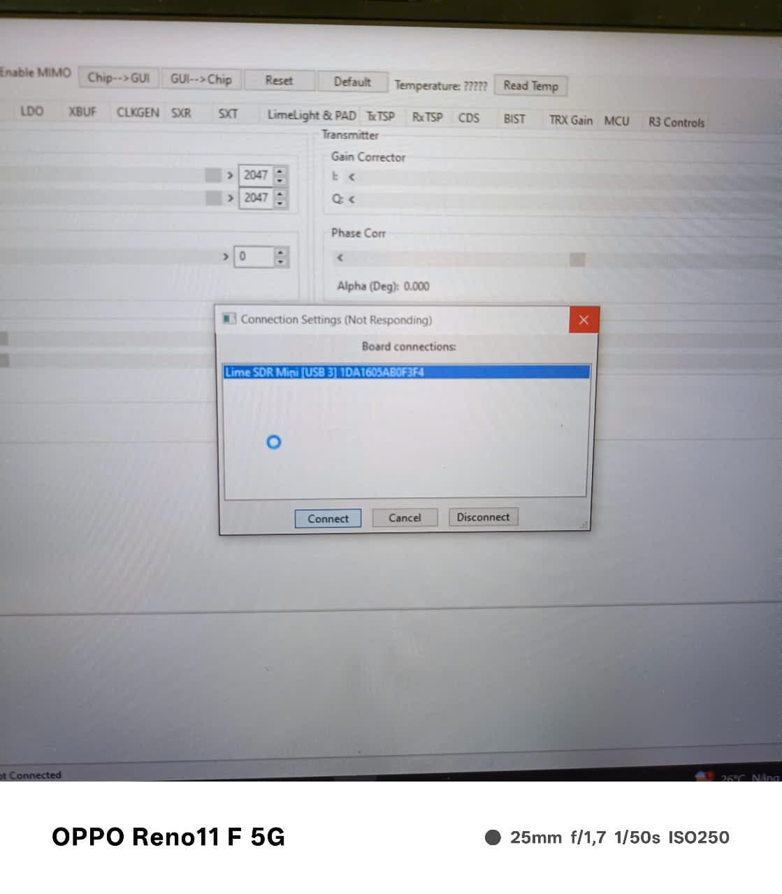

I tried to set up software connection but can not connect.
The device is correctly visible in device manager, that means the USB controller/firmware part is working. It might be that the FPGA gateware is not working properly.

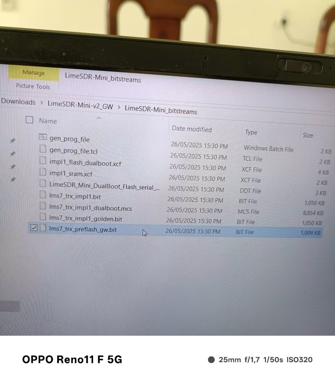

Did you tried to update the FPGA gateware with the one you are showing in the screenshot?
