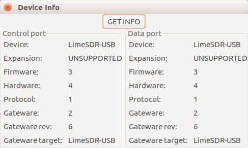

For Windows, I’m assuming that you installed the Cypress drivers for USB 3.0 support, right? Also, recheck using LimeSuiteGUI and perform the Connect, and then use the Device Info feature from the modules to see if your Lime is running USB 3.0 or not (you can also do this from Linux using LimeSuiteGUI, too). If you only see USB 2.0, then you’re either plugged into a USB 2.0 port (no offense, it’s happened to me A LOT) or you have no USB 3.0 resources that the Lime can see. Just reload the driver for USB 3.0 and see if it corrects itself.
None taken Marty, I appreciate the reminder. Fortunately, the ports on the front of my PC were easily separated since I built the machine myself. Unfortunately, if I plug into either USB3 plug I get the same response.

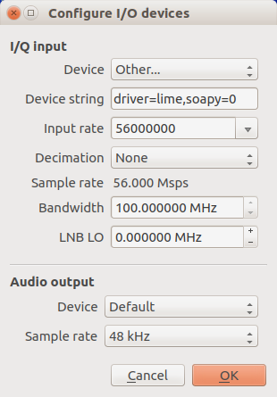

@SimonG4ELI I got my USB3 card in the mail today. It appears to be working. Below are the best settings I could get to work with gqrx. Anyone using anything different with gqrx?

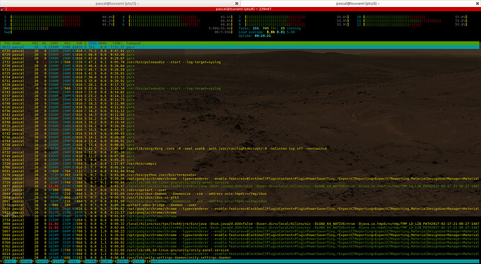

@csete, Below is the output from htop on my 12 core hyperthreaded PC. The loads look a bit high, and I’m surprised to see so many gqrx processes running. Is this normal? This is with the settings above.
