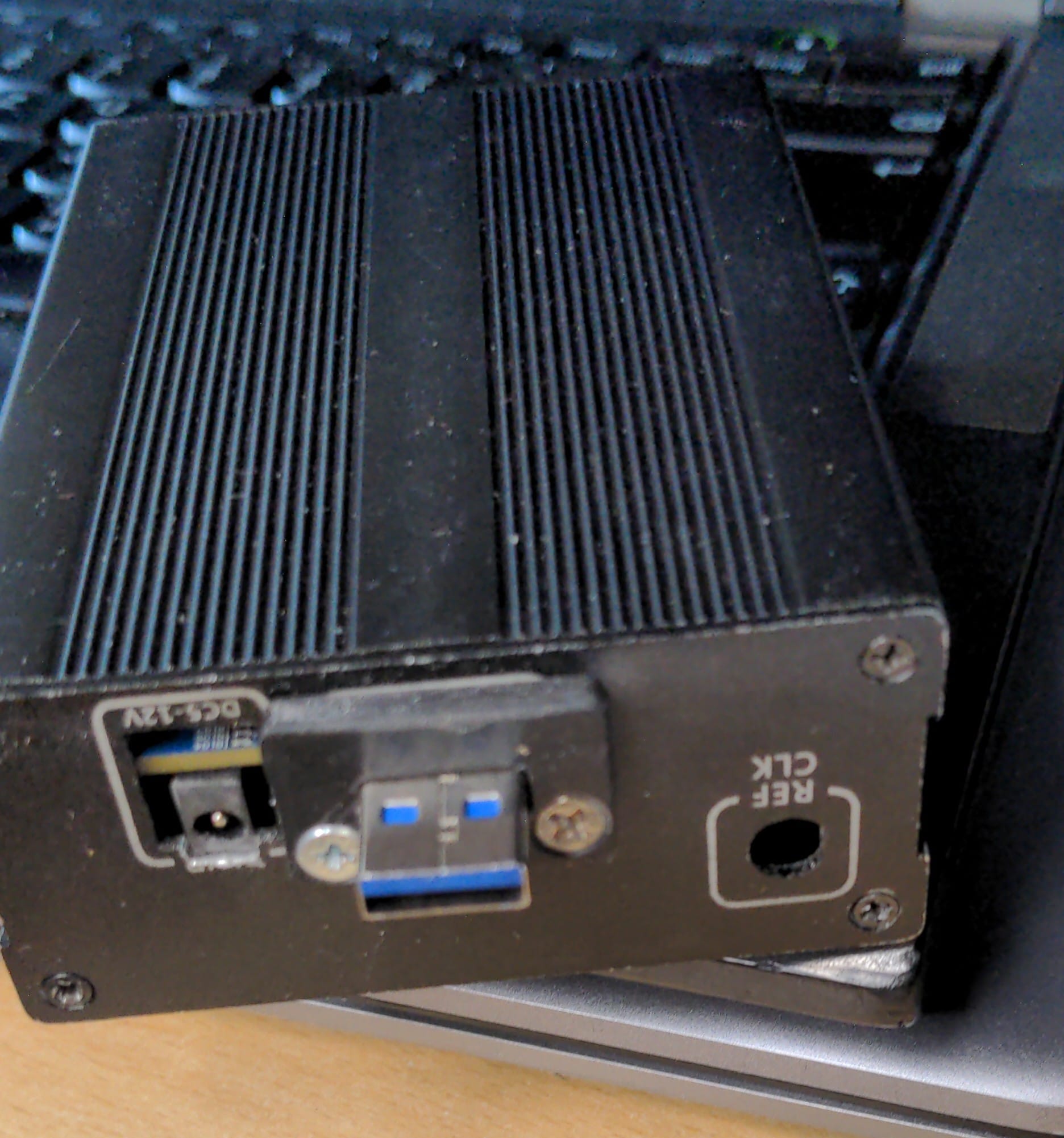

@ricardas @andrewback I can confirm that LimeSDR now works on Alpine, I has also hardware issues in the mean wile with USB connector (bad design), always losing connection, so I need to find someone with 3D printer to build for me PVC fixer, so that connector won’t suffer in future, thanks for help;
Robin.
