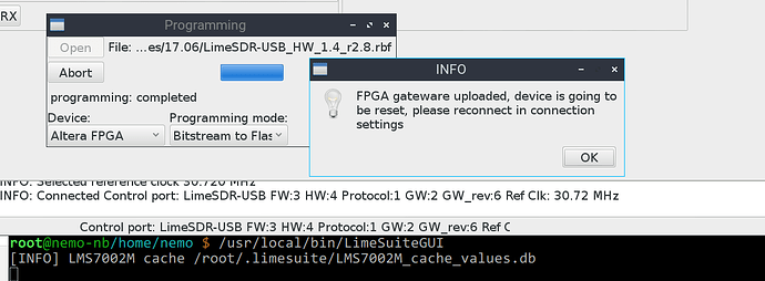

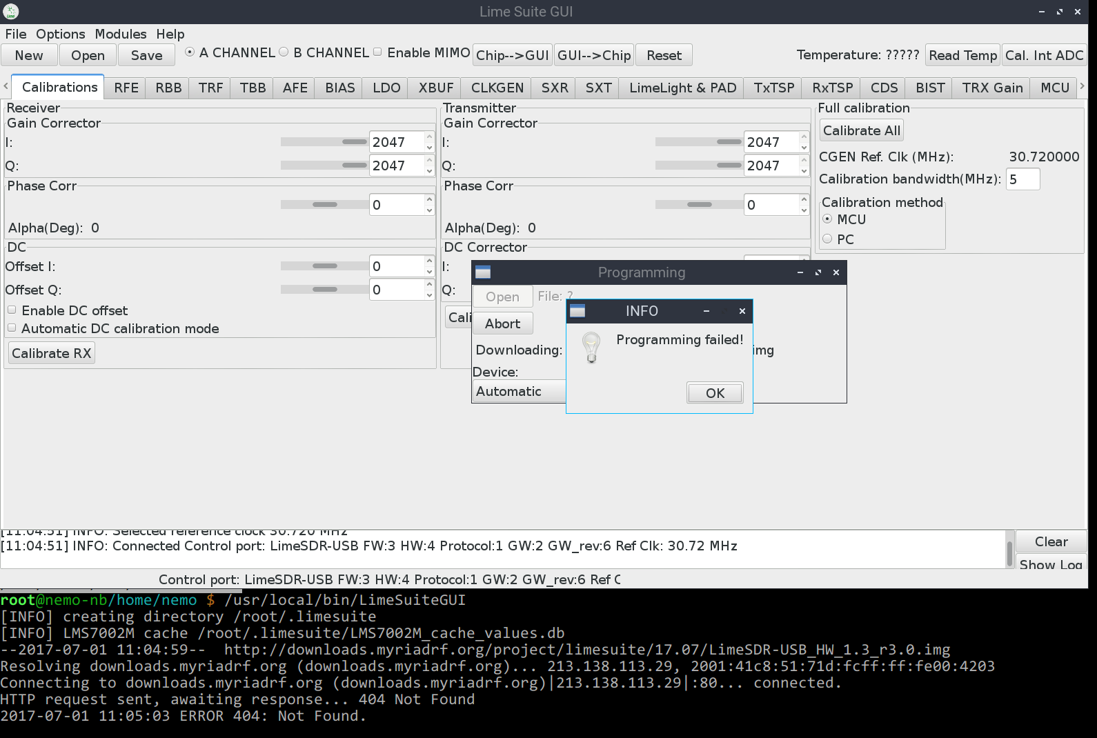

LimeSuiteGUI

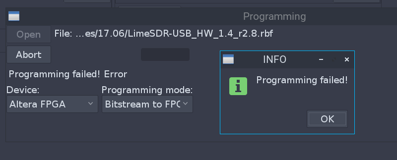

Manually downloaded firmware LimeSDR-USB_HW_1.4_r2.8.rbf from index - powered by h5ai v0.29.1 (https://larsjung.de/h5ai/)
LimeSuiteGUI root
Started GUI as root user. The program is downloading from location that does not exist - there is no 17.07 in index - powered by h5ai v0.29.1 (https://larsjung.de/h5ai/)
when doing manual update you need to select programming mode: ‘Bitstream to Flash’
